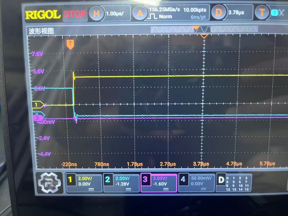

FrankZou
0xFF received erroneous waveform0xFF received erroneous waveform
0xFF receives the correct waveform0xFF receives the correct waveform
The yellow color represents one of the data lines.
Green represents the RD line.
Purple represents the CS line.
As can be seen in the picture, the yellow signal has an ascending pulse but does not remain.
During the test, it was found that when using an oscilloscope probe to measure the ALE signal, the received data was correct. However, when the probe was not used to test the ALE signal, the received data was incorrect. The ALE signal is normal. The controller we use communicates with the SJA1000 via a TI level conversion chip, which converts 3.3V to 5V.

JozefKozon
Dear Frank,
This behavior suggests a signal integrity issue, possibly due to:
  1. Weak Pull-up/Pull-down or Floating Lines:
    • The oscilloscope probe might be adding capacitance or acting as a weak pull-up/down, stabilizing the ALE signal.
  2. Impedance Mismatch or Reflections:
    • The level shifter or PCB layout might be causing reflections or improper voltage levels.
  3. Timing Issues:
    • The ALE signal might be marginally timed, and probing it affects the timing enough to make it work.
  1. Add a Pull-up or Pull-down Resistor to the ALE line:
    • Try values like 4.7kΩ or 10kΩ and observe if stability improves.
  2. Review Level Shifter Specs:
    • Ensure the TI chip supports the required drive strength and timing for SJA1000.
  3. Try Adding a Small Capacitor (e.g., 10–100 pF):
    • This can help filter noise or stabilize the signal if probing helps.
