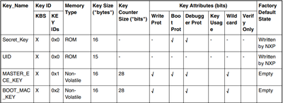

I have a question regarding SHE-key update protocol. I'm using a tool to calculate M1,M2,M3,M4,M5 format of key to be stored in the corresponding SHE slot, by providing the needed input (keyID, unitID, counter, usageflags, AuthID, KEY_AuthID). Given the fact that the MASTER_ECU_KEY is used as authentication key to update all the other SHE-keys, what should be the AuthID and KEY_AuthID value to be provided as input in order to calculate the MASTER_ECU_KEY in M1,...,M5 format?
Seeing the AN5401, it seems that KEY_AuthID shall be all 1's, is it correct? What about AuthID?

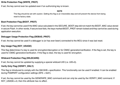

Just one more question: what about the attribute_flags? Should I decide the value and the '0' in your screen is just an example or should it be always set to '0'?

lukaszadrapa
The attribute flags should be set as you need.
For example, if you want to set KEY_USAGE to 1 (that means the key will be used for CMAC generation/verification), the value should be 0b000100 (WRITE_PROT is MSB, VERIFY_ONLY is LSB).

Ok, but from Table 1 of AN5401 I also see that the key usage attribute cannot be defined for the MASTER_ECU_KEY and the BOOT_MAC_KEY, as well as the boot protection attribute for the BOOT_MAC_KEY.
So, what value should I put in calculate_M1_to_M5 for these unavailable attributes?

lukaszadrapa
I was talking in general, that was just an example. If such attribute is not available for a key, keep value of the attribute as zero.

lukaszadrapa
Hi @ale_di_vi
I made this compilation from AN5401 which should answer it:
