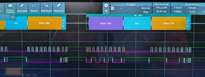

When trying to program FPGA bitstream to flash using SC18IS606 I've faced a strange problem that manifested itself with FPGA not starting properly from programmed memory.
After looking into the problem and doing some logic-analyzer work I have found that the first byte of bitstream readout was equal to 0xF1. Surprisingly, such value did not occur in a bitstream.
First I thought it's some transmission error on I2C side. However, analyzing it revealed perfectly normal transmission. Then I started recording the whole page write operation, and it turned out that there was an extra byte at the end (it had 261 instead of 260 bytes - 256 bytes of page data + 1 op code + 3 address bytes) with value 0xF1 that due to address wrapping was written at 0-th byte.
The only place where 0xF1 occurred in my code was writing operation (interrupt register clear)  just after writing a page that was supposed to check (by getting ACK) that write operation was finished, and if next operation can be performed.
For some reason, this 0xF1 opcode was sent over SPI. It is totally unclear to me why as 0xF1 was sent in a separate I2C operation (see fig.).

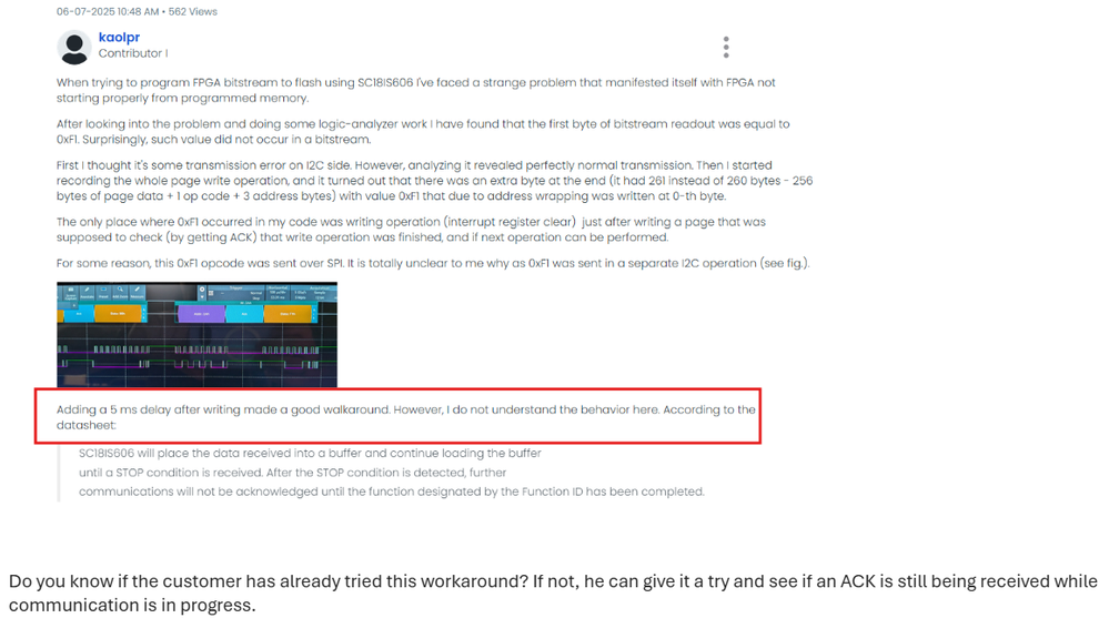

Adding a 5 ms delay after writing made a good walkaround. However, I do not understand the behavior here. According to the datasheet:
SC18IS606 will place the data received into a buffer and continue loading the buffer
until a STOP condition is received. After the STOP condition is detected, further
communications will not be acknowledged until the function designated by the Function ID has been completed.
From this I read that if the operation was not finished, the device should NACK. But here, not only it did not NACK (even with top frequency of 1843 kHz should take a bit more than 1ms) but it seems it put this op-code into the buffer.
Am I missing somthing here, or this is not what was expected?

I observed the same issue during a page write sequence to a AT45 flash device.
During the flash write process, the SC18IS606 replies with an ACK despite the SPI communication is fully in progress.
It seems to me that the necessary (and documented!) NACK response for indicating busy mode of the SC18IS606 device doesn't work at all in this situation.
Please see the attached images in order to comprehend the issue.
In my case the behavior of the SC18IS606 also leads to the problem, that further commands are send to the AT45 in order to read its status register for busy mode. These commands are then appended to the data in the SC18IS606 buffer which are then appended in the SPI transfer and result in a flash buffer write overflow (the first bytes of the flash buffer are overwritten with the status register commands). Of course, this creates ton's of garbage data in the flash...

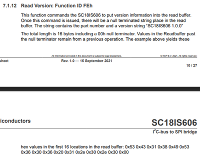

  3. Provide customer’s SC18IS606 FW version (Function ID 0xFE).

1. On the first image (01 ...), you can see from 168.5ms to 170.42ms the transfer of the data to be written into the flash device, that lies on the SPI interface after the SC18IS606.
   The I2C transfer is then completed with the shutdown of two I2C multiplexer ICs (addr 70 and 71, as slighetly observable on the image) up to 170.9ms. This part shouldn't be of your concerns.
   The actual data transfer of the flash data to be written from the µC to the SC18IS606 ends at 170.42ms and you can see, that the SC18IS606 immediately starts its SPI transfer to the desired flash IC:
   ==> see the waveforms in the upper half of the image from 170.42ms to ~175ms.
   During this "long" SPI transfer, you can observe in the lower half of the image, that from 171.38ms to 172.34ms the next I2C transfer to the SC18IS606 is performed in order to poll the state of the transfer.
   As this transfer gets an ACK instead of a necessary NACK because of the busy SC18IS606 with an ongoing SPI transfer, the microcontroller proceeds with further transfers which lead to the mentioned behavior.
   On the other two images (02 and 03) the red-framed area is zoomed in in order to see exactly the waveform of the error-prone response.

3. I am not aware of all chip-revisions we are using in the field, as we delivered systems with this IC for the past two years and I didn't register the IC version for each component we build.
   Nevertheless, I am aware of at least two versions of the IC that I have in office. One of them is SC18IS606 1.0.1 and the other was SC18IS606 1.0.2 (where I attached wires for the attached scope images).
       For now I am sure that both IC revisions seem to work alike for this issue.
