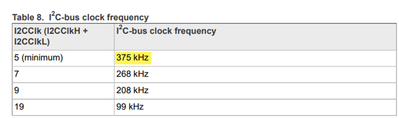

4.   I2C clock rate is configurable via I2C_CLKL, I2C_CLKH registers (registers $07, $08).
But it appears they are calculated differently & have different defaults.
For '700 bridge IC doc I see default settings of I2C clock regs { R07, R08 } ==  {$13, $13}.
For '704 bridge IC doc I see default settings of I2C clock regs { R07, R08 } ==  ($13, $00}.
The settings are kinda (awkwardly?) expressed in the '700 doc - they seem to indicate one register sets the clock Hi level period duration, and the other sets the clock Low level period duration.   But in the '704 doc, the Hi & Low registers are described as a combined 16-bit value {R07, R08}={LSB, MSB}.  The formulas differ too.
  (a)  is it true the '700 vs '704 ICs have different methods of setting I2C clocking ... or am I
        just reading things strangely?  The fact the reset defaults btwn '700 and '704 IC are
        different is interesting.
  (b)  It looks like docs for either '700 or '704 indicate 369-375 khz is maximum I2C clock rate.
        Any way to get to std 400 khz clock rate?

  • Is there anyway to get 400Khz I2C clocking on the '704??  (...instead of
    supposedly max 375 KHz?)
Bill

  3. My apologies for the misunderstanding. The maximum I2C-bus clock frequency is 375kHz.
