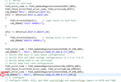

Currently, I am encountering a problem related to the DIAG_SF_ERR_ADR register during the initialization of the FS6522 chip. The specific situation is as follows: after completing LBIST and ABIST1, the self-check shows "OK" and the fault count of the DIAG_SF_ERR_ADR register is 0. However, after reading the next register (regardless of which one is read), the fault count of the DIAG_SF_ERR_ADR register becomes 5. Have any of you encountered the same problem? I'm seeking an answer and haven't been able to identify the cause yet.

It will also occur in the debugging mode. Further investigation revealed that this situation only occurs during the first run after the program is burned. After a restart, the error fault count returns to normal. The initialization process follows the manual and involves reading and writing to the registers.

Here is my initialization process code. During the initialization process, no reset occurred. According to the data manual, the error fault counter should be 1 in the initialization stage if no fault occurred. It should be reduced to 0 after seven correct dog-feeding operations. The dog-feeding process was normal, but the value read from the fault error counter was 5 instead of 1.
