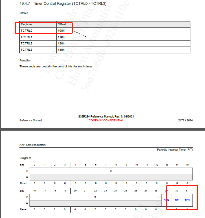

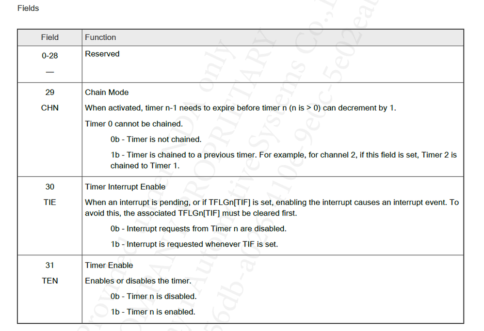

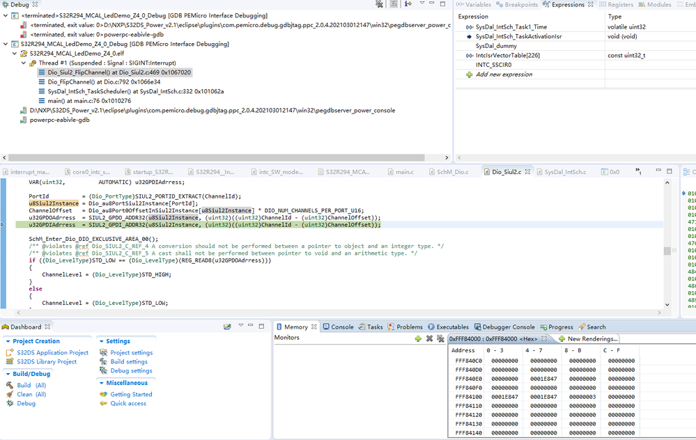

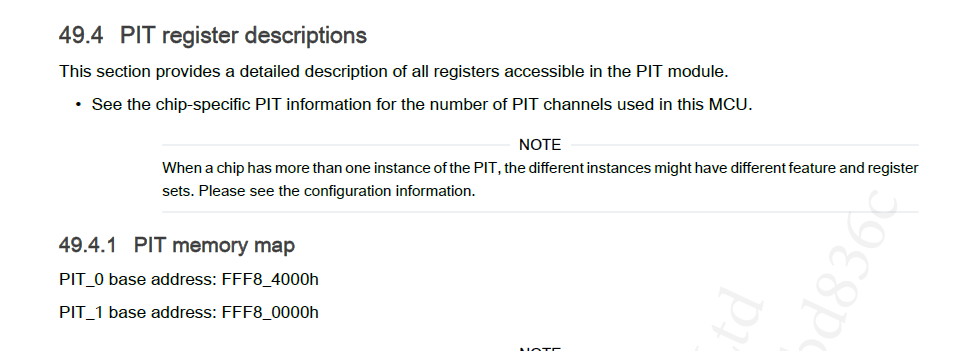

        The compiler used in this project is WindRiver, interrupt cannot be entered. Can you help to solve it?
In addition, I found the root cause of this problem is startup.s, interrupt vector is not registered. I took simulation, and the state of the register is correct, as shown as in the figure.b5c61fe9bf0658f5ecad23f42d00ca3.pngb5c61fe9bf0658f5ecad23f42d00ca3.png71335f28160273c7ff1dd8d20f87a83.png71335f28160273c7ff1dd8d20f87a83.pngcde8ba05ee5c8d058c979dcb0711ad7.pngcde8ba05ee5c8d058c979dcb0711ad7.png1bf73a24688940dd07dbfc8236a2969.png1bf73a24688940dd07dbfc8236a2969.png

You should find the vector table, which registers the interrupt, in the startup code, e.g. Vector_Vle_App_Interrupt.s, then modify the corresponding interrupt handler ID. The vector table address then should be written to IVPR register. See the attachment.
