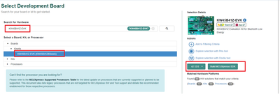

You can download our KW45 SDK on this website:
https://mcuxpresso.nxp.com/en/welcome
"Select Development Board" -> input "KW45B41Z-EVK" then choose SDK version, and download it.
