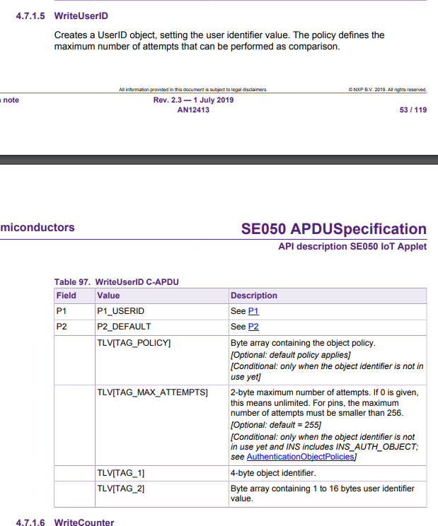

I have created an Authentication object(UserID)
APDU: 804107000E1202000341040F7FFFFF42020FFE
CLA: 80 INS: 41, P1: 07, P2: 00

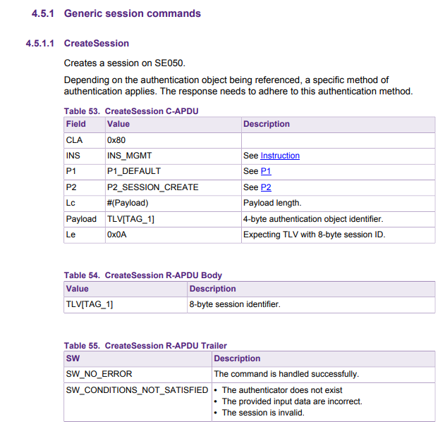

and then created a session using this user ID.
APDU: 8004001B0641040F7FFFFF0A
CLA: 80 INS: 04, P1: 00, P2: 1B

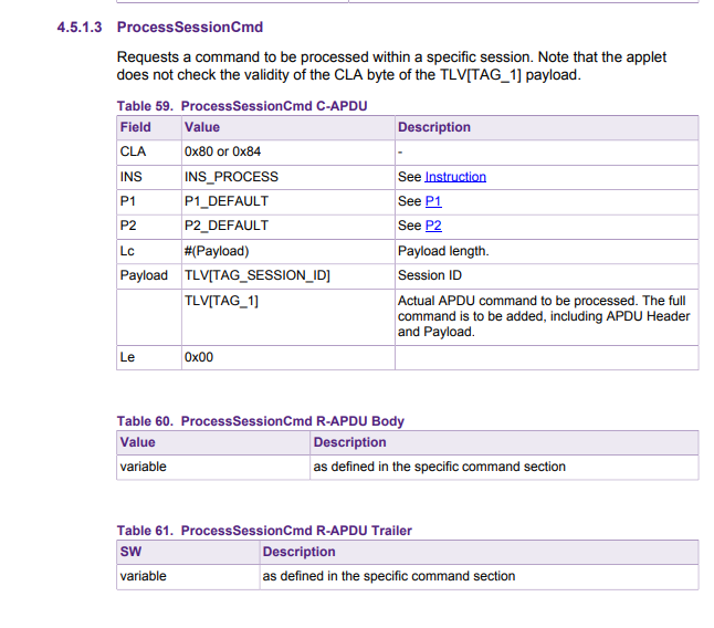

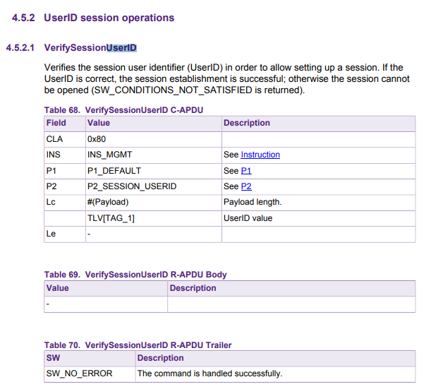

Now, when I want to open this session using VerifySessionUserID command
APDU: 8005000015100801F144DFECE5FD8E41098004002C0441020FFE00
CLA: 80 INS: 05, P1: 00, P2: 00
Note: I have wrapped VerifySessionUserID  command in ProcessSessionCmd command.
it gives me error 'SW_CONDITIONS_NOT_SATISFIED'.
I don't understand why am I getting this error when I am writing the correct UserID value and also the correct auth object ID ?
Because as explained in the document, we get this error only when our userID is not correct.

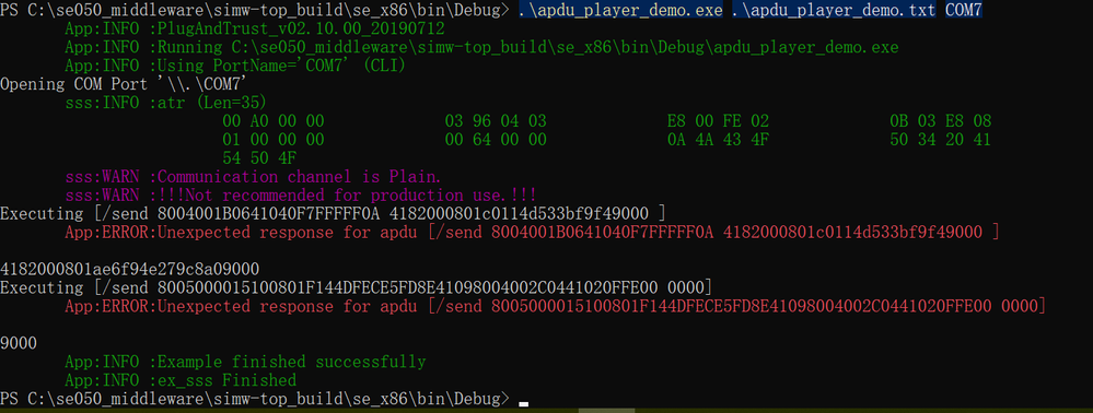

The cause is due to you use APDU player to launch CreateSession and VerifySession separately. That would make the session id you got from CreateSession  became invalid when you start a new apdu player to run the VerifySession command. but if you run VerifySession right after CreateSession within the same APDU player demo, the device returns 9000.

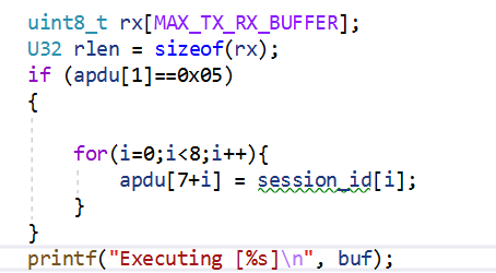

For test purpose, I updated the session id info in the apdu player demo as below:

The first command (createSession) that you are executing, is giving 8-byte session ID in response (01AE6F94E279C8A0). But in the next (verifySessionUserID command) you are putting the session ID that i used in the example I sent you in my first question.
And I also tried adding the above code lines in my apdu_player.c file but it is giving the error (identifier session_id is undefined). From where I can get this session_id? Is this the session_id from the response of the createSession command?

The session ID put in verifySessionUserID command is just for dummy purpose, the 8-byte session ID in response (01AE6F94E279C8A0) is the really session ID I got in that test, so before launching verifySessionUserID command, I replaced the dummy session ID with the one I got from the response of createSession command.
Please refer to the attachment for more details.
