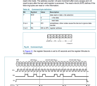

Am using PCA21125 RTC and i would like use the Alarm functionality, after the configuring the control-2 register as stated in data sheet still am not able to see INT signal generated.

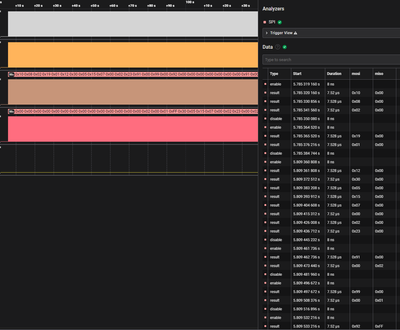

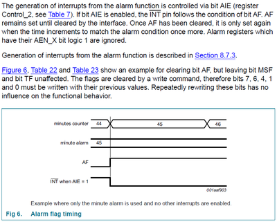

Attached logic analyzer log file as well here the brief info about what we have loaded to the concern register's and also some screen shots of the data sheet statements related to alarm functionality.
One more weird behavior observed is that by default and all the time INT pin is low, by default it should be high. But if we read the control 2 register no flags has been set, Do we need to verify anything else also ?.
Control-1 : 0b00000000 - Normal operation
Control-2: 0b00000010 - AIE bit set INT pin to follow AF
command to write into alarm minutes register (0b00011001) and data sent to register 0x09h is 0b00000001 - Enabling and alarm interrupt for every minute

  1. Did you try to enable a minute interrupt by setting the MI bit in the Control_2 register?
  2. If you want to write to the Minute_alarm register, please make sure you are using its correct address. Unless it is a typo, you are using the address of 0b00011001 = 0x19h, while the correct address is 0x09h.
Otherwise it seems that you are doing everything right. There is an example for the Alarm function in the UM10301, chapter 12.2.

It's not the typo 0x19 is the command to write into the register address 0x09h

By default both the day and weekday alarms are disabled ("1"), so that is not mandatory.
Since you write 0x01h to the Minute_alarm register, you can also use the minute interrupt (MI = 1) as an alternative way to achieve one minute interrupt.

After correcting still am not able to see INT generated for alarm functionality but minute alarm is working properly.

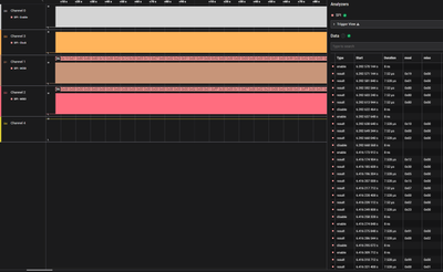

Can you please take look into both attached logic analyzer logs (you need logic2 software from saleae to view it).
Please help me in identifying what am missing to configure to generate alarm functionality.

One more strange behaviour observed after recycling the power with out coin cell, the data in the register 09 is not holding .. even after writing to register 09 on after immediate power cycle. please take a look into the logs attached.
