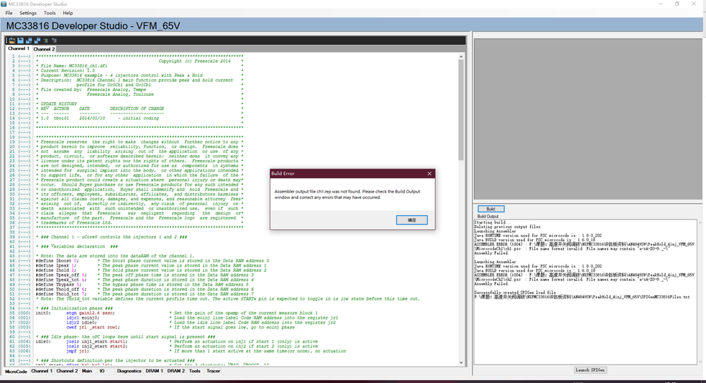

I downloaded the AN4849SW four injector and pump drive source project.However,When I bulid the output,it has some problem as the picture shows.I don't know how to recorrect it.Please help me !Thank you very much!

Hi Kai,
The error is coming from the microcode assembler. WeI suspect that the Chinese characters in the file path are causing the issue.
If possible, move the project to a file path that contains only English characters.
