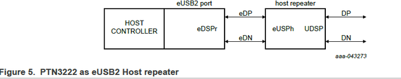

Is it possible to configure PTN3222 as Host-USB2 to eUSB2 host?
I other words, can PTN3222 convert a normal USB2 host port to eUSB2 host?

More specifically, I am interested if the following configuration would allow me to exercise all normal USB2 traffic:

Hi Alex
Sorry, unfortunately your design will not work.
PTN3222 eUSB side has to be connected to a controller, either Host or Devise.
Have a great day and best of luck.

Hi Alex
I'm not sure if I understand you correctly
Do you mean this?
