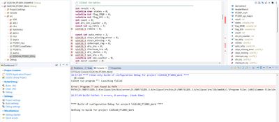

I Imported the Example program - "S32K144_PT2001_EXAMPLE" from FRDMPT2001EVM product website. I am unable to compile and build the example program. I need help setting up the build environment and compiler settings.
IDE version: 3.4 Build id: 201217 (Update 3)
SDK version: S32K1XX SDK RTM 4.0.3
PT2001 S32K144EVB

The example is originally developed with S32FS for ARM v1.2 and is not compatible with S32DS v3.4, The latest version of S32DS usable with the example is S32DS for ARM v2.2 - please use this version.
