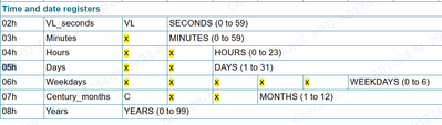

Why the unused bits in the register change to 1

Please note that the “X” means undefined. I mean, they might be logic 1 or 0. Such values are not relevant for the behavior of the device.
