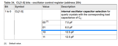

In one of our products, we have used PCF85263A RTC IC. With the default kernel driver and hardware design, it is observed that in 11 hours, RTC time was ahead by 20 seconds! So, we tried to adjust the time by writing into the offset register. But after trying 6 values, we are not able to have the RTC time correct with the current time.
In the kernel driver, I have set the fast mode for offset (OFFM=1) and tried these values: 4, -4, -9, -15, -21 and, -18. When I checked for load capacitance of oscillator, I found that in hardware design, no capacitor is connected. The oscillator datasheet shows that the Load Capacitance is 6pF.
Kindly guide me for the correct values to write into offset register (0x24) and Oscillator register (0x25).

1. Load capacitance:
Yes. the kernel driver is not updating this and the default value is for 7pF. Ok. will update this for 6pF. Actually, I was confused because there is no external capacitor with an Oscillator in the design.

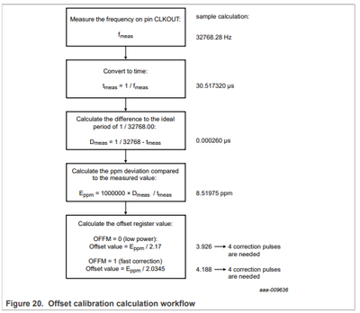

2. Offset calculation.
One pulse time observed is 30.60 uS. So, the calculation should be as below:
Dmeas = ((1/32768)*1000000 - 30.60 uS = −0.082421875 uS
Eppm = 10^6 * −0.082421875/30.60 = −2693.525326797.
Now, as we know this value is out of range for Offset register, so we cannot use this value, right?
The datasheet of the oscillator indicates that the ppm value is +/-20ppm.
According to this, the calculation results in 9.830425166.
the offset register should have 9 or 10 value in fast mode (OFFM = 1). Kindly confirm.
[A] I have checked your calculation and they are correct. The deviation is too large and cannot be corrected with the Offset register. Have you set the load capacitance to the 6pF as required per crystal? How did you measure the CLKOUT frequency?
[A] You can test it, but I don't think it will correct the large deviation. A crystal with +/- 100ppm or better is recommended. Yours crystal has +/-20ppm, which is excellent. So there shouldn't be such large deviation. Could you please test another crystal? Another piece in case this one is faulty or from an other manufacturer.

Dear Pandurang Chauhan,
[A] Please set the Load Capacitance CL[1:0] bits in the oscillator control register (address 25h) to 01, to 6pF. By default 7pF load capacitance is set.
[A] Please make sure you have the COF[2:0] bits in Function register address 28h to the default value. The output frequency on the CLK pin will be set to 32768 Hz.
After that please follow the Offset calibration workflow, section 7.8.3 pages 32 and 33 in the datasheet.
Measure the frequency on the CLK pin, convert to time, calculate the difference, calculate the ppm deviation and calculate the offset register value.
With Best Regards,
Jozef
