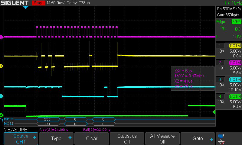

On a new set of boards produced by our vendor after anywhere from instantly to a few days the RTC will lock up. Same firmware, new batch of chips, old ones do not have this problem.

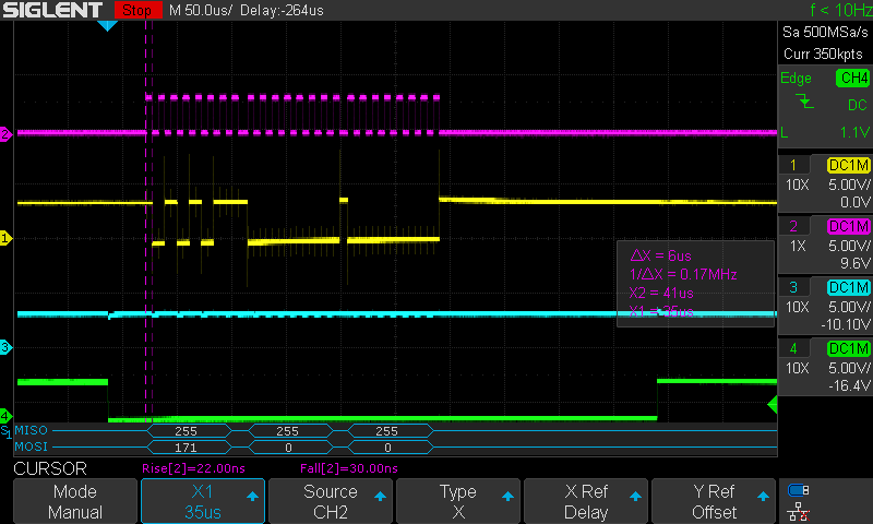

By lock up I mean it no longer responds to commands and returns 0xFF for all bytes on the MISO line which causes our product to be unable to properly function. If anyone could help that would be awesome, this is a frustrating issue. The processor we are using with it is a KW41Z and using the SPI SDK. On that same SPI bus we have an analog devices DDS Chip and it functions perfect while this PCF2127 is constantly locking up.
