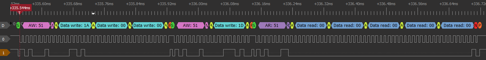

I have a problem with one PCF2127 RTC IC.
The clock works, I can set and read the time via I2C.
The other feature I'm using is the backed-up RAM.
But when I write the registers and read them back, I get only zeros.
The PCF2127 responds, but the values are zero.
It looks like this:

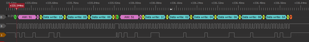

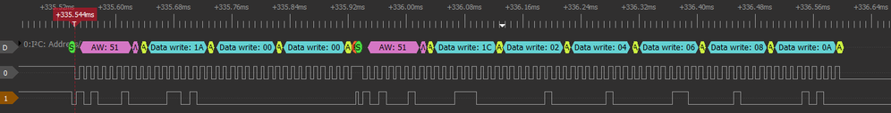

Writing 5 bytes starting at address 0:
Reading the 5 bytes back:

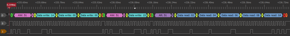

On another unit (the same device type, identical MCU application) it behaves correctly:
I also tried writing 5 bytes @ address 64, but with the same result.

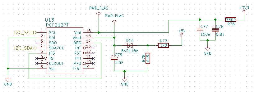

The schematics of the circuit:
It seems to me that the PCF2127 is defective.
Is there any procedure that could be used to test/identify the problem or restore the correct function?
Has this behavior been observed before?

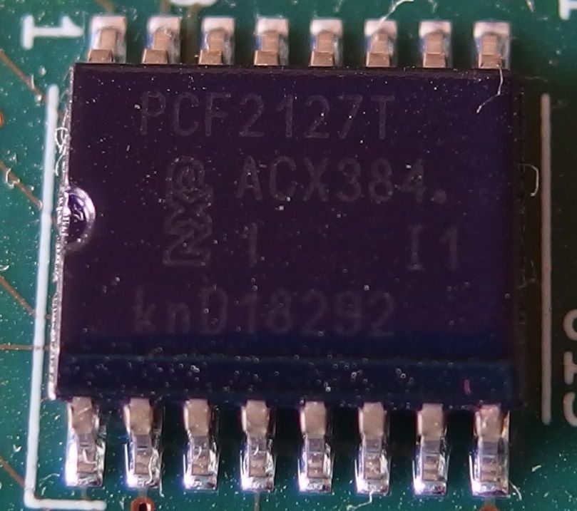

  1. So far I had six devices in my hands, two were bought some months ago for prototypes and four belong to a new batch of 16. The 16 devices are soldered, but so far I have commissioned only 4 of them. All are from Digikey, so I do not expect them to be counterfeit. I observed the behavior only on one device.
  2. The two from the first batch work, two from the new batch were sent to a customer without testing of this feature (An automatic test only checks whether the RTC communicates and if the time runs and is retained. An automatic check of the RAM was not implemented) one is faulty (that was found out after delivering the first two) and one which I tested after discovering the problem works as expected.
    That leaves 12 more to be tested, not counting the two already delivered which would inevitably return later...
  3. Image of the faulty device is attached. The PCBs got a layer of protective varnish, which makes the markings a little harder to read. And it gathered some dust during testing.

I am afraid that it will be necessary to perform a detailed analysis of faulty parts by our quality engineers in their lab. Our standard procedure for this is to submit a CQI (Customer Quality Incident) request through a distributor you bought the parts from (DigiKey).
Tomas
