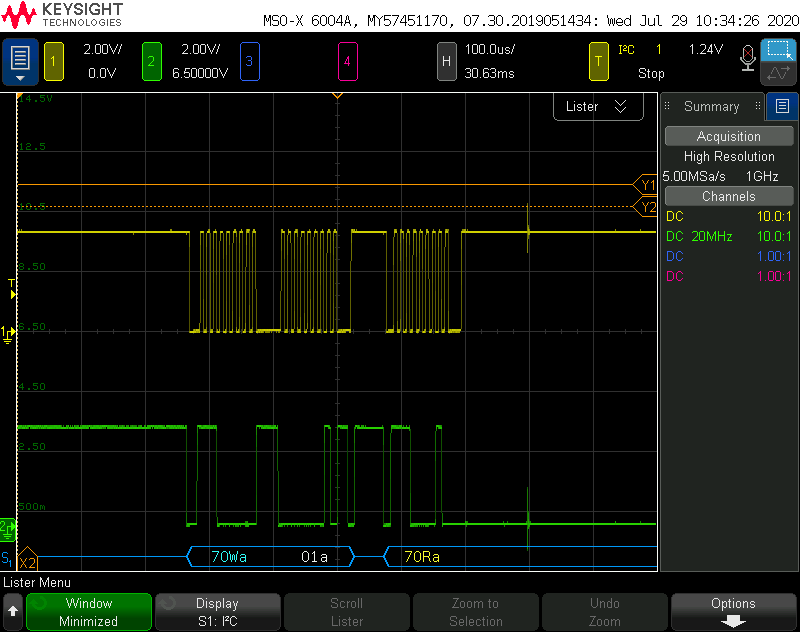

I designed this into a new product or ours.
I notice that the chip frequently results in an I2C bus stuck event that needs recovery.
This occurs when writing the control register for a MUX selection, followed immediately bu a read to confirm the correct selection.
The bus will sometimes become stuck in that SDA remains low forever or until bus recovery procedure.
The bus become stuck at around bit 8 or Ack of read data address. See attached wave capture.
This happens at a frequency of around 1 in 1000 or in my case about every 3 minutes.
Bus operation is 100kHz.
What can cause this problem?
The bus signals are clear and beautiful. Is there a minimum time specification between a write followed by read ?
I cannot see it in the datasheet.

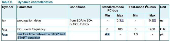

TomasVaverka
Hi Bernt,
Yes, it can be caused by a short interval between a write and read command. There is a minimum required bus free time which is 4.7us in Standard Mode (100kHz).
I hope it helps!
Tomas

berntau
Hello, as per the attached scope capture, that condition is not violated. There is almost 100us time from STOP to START when this happens.
I have also ruled out any downstream devices as the cause.
9,973 Views

berntau
Hi Tomas,
I am not sure which noise you are referring to as the signals look very clean for real world signals.
If you mean the spikes AFTER the fact, that is because the CPU switches off the I2C bus and returns to GPIO mode so that it can measure and recover the bus. That is not avoidable but as said, it is only AFTER this chip has locked up .
Also please note:
1) The problem occurs always at the same bit in the same message.
2) None of the downstream or other devices have any issues, only this particular MUX chip.
B
