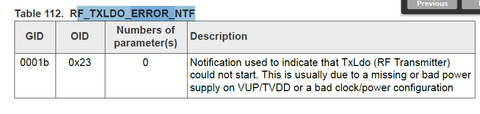

The Answer is received is,
Answer[0] = 0x61,
Answer[1]=0x23,
Actually Answer[1] is received 0x05 or 0x03 but i get ox23,
So please suggest me i am doing Right or wrong configurations or not.

[15:06:02:616] NCI << 61 23 00
[15:06:02:630] NCI << 61 23 00
In NxpNci_WaitForDiscoveryNotification we get stuck at the following code snippet, the response we are receiving is 0x61 0x23 0x00 but it requires first 2nd byte to be 0x03.
    do
        if(NxpNci_WaitForReception(Answer, sizeof(Answer), &AnswerSize, TIMEOUT_INFINITE) == NXPNCI_ERROR) return NXPNCI_ERROR;
    }while ((Answer[0] != 0x61) || ((Answer[1] != 0x05) && (Answer[1] != 0x03)));
Please help me with this issue  of unable to discover ISO15693 based NFC tags in RW mode.

Hi @takshpatel
I would suggest you check power supply and settings in Nfc_settings.h.
Error you are getting is this one.
4,356 Views
