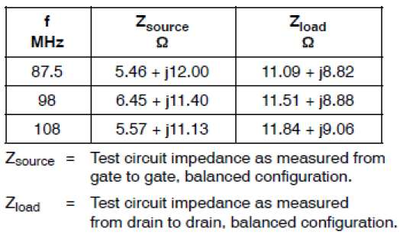

Re Reference circuit for MRFX600HR5 board D111952 operating 88 to 108MHz.  Circuit shows a 1:4 Guanella balanced transmission line transformer followed by a 1:1 balun at 50 ohms.  So far so good.  The 1:4 device I believe operates from a nominal 12.5 ohms to 50 ohms with the transmission line impedance being the geometric ratio giving 25 ohms.  However the parts callout shows two lengths of 35 ohms impedance cable.  I need some help here.  I am also looking for correct quiescent current setting to best operate this device at 50MHz at best linearity.  That and a pointer to preferred biasing/device temperature compensation means. Such compensation does not seem to be on the reference circuit.  JSR.

You are right. 25 Ohm TL impedance is required to built almost perfect 1:4 impedance transformer.
However, the target Zload of the device is not real 12.5 Ohm but complex impedance. Using 35 Ohm coax provides additional reactance at the operating frequencies. It compensates reactance of the target Zload. I simulated load circuit of this design for 25 and 35 Ohm coaxes (DX: 66 vs 84).

In a broadband design, like NXP MRFX600H 87.5-108 MHz reference circuit, no matching circuit exist that could optimize impedance in the whole operating frequency band and different power levels. In this amplifier, the design target was to achieve flat gain and power performance vs frequency at fixed input power. Generally, the matching is not the best at any given combination of the frequency and power, but, it is nearby optimal.
If the matching is not the best, increasing the power level can move load impedance of the transistor in the direction from or toward the impedance of the loadg circuit and thus the gain can change in either direction. It is the reason why I can not provide a general rule for quiescent current to achieve the best linearity. Optimal value should be obtained by RF testing or by simulation.
