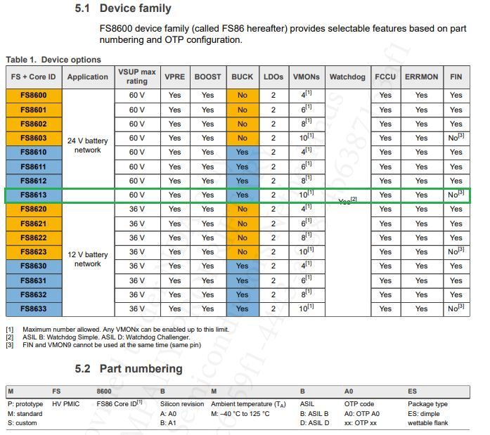

Hi, ı would like to order the "MFS8613BMDA0ES" also programming kit "KITFS86SKTFRDMEM" but ı would like to be sure correct part number. I research the part numbers but I didn't see MFS8613BMDA0ES was non-programmed. Could you help me please, is the "MFS8613BMDA0ES" non-programmed.

just to make sure I understand, lets say I buy the MFS8613BMDA0ES, will I be able to program it myself with some programming socket board?
Will I be able to OTP program it in respect for voltages, UVP/OVP limits, timing sequences, etc, or does this count as a custom configuration?

Yes, it is non-programmed.
