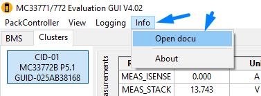

We are using FRDM-KL25Z as MCU development platform to operate MC33772x EvalGUI.
When we click the save configuration, all the thresholds and Regitors are reset to original values.
We want to know what the steps to save configuration by using GUI.

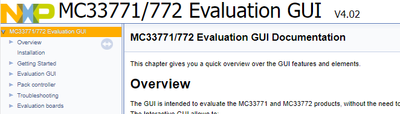

the save configuration is not meant for saving the register settings, but for saving the interface and selected port. Please click the info button and then the Open docu and it will open for you a user guide to the GUI.
