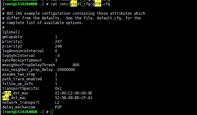

2. the swp2 port is connected directly between the two boards, run"ptp4l -i swp2 -f /etc/ptp4l_cfg/gPTP.cfg -m" separately on the two boards, the result shows they are not synchronized. detail configurations for time synchronization as below:
2.1 Slave gptp.cfg:
2.2 Master gptp.cfg

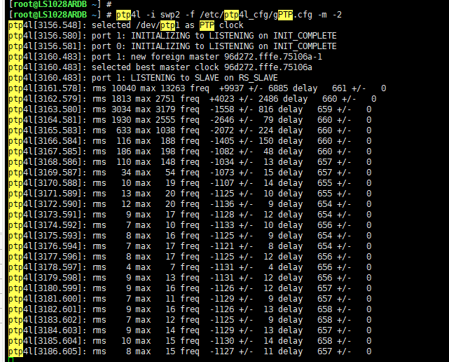

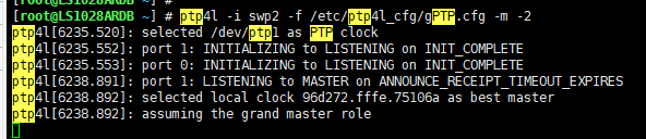

2.3 run"PTP4L" on master and slave:
2.3.1 master feedback:
2.3.2 slave feedback:

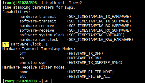

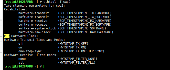

2.3.3 master swp2 capability:
2.3.4 slave swp2 capability:

Please refer to the following log.
board A:
root@localhost:~# ls /sys/bus/pci/devices/0000:00:00.5/net/ swp0 swp1 swp2 swp3 root@localhost:~# ip link add name switch type bridge root@localhost:~# ip link set switch up root@localhost:~# ip link set swp0 down root@localhost:~# ip link set swp0 up root@localhost:~# ip link set swp1 down root@localhost:~# ip link set swp1 up root@localhost:~# ip link set swp0 master switch root@localhost:~# ip link set swp1 master switch root@localhost:~# bridge link 7: swp0 state UP @eno2: <BROADCAST,MULTICAST,UP,LOWER_UP> mtu 1500 master switch state forwarding priority 32 cost 4 8: swp1 state LOWERLAYERDOWN @eno2: <NO-CARRIER,BROADCAST,MULTICAST,UP> mtu 1500 master switch state disabled priority 32 cost 100 root@localhost:~# ifconfig switch 1.1.1.1 netmask 255.255.255.0 root@localhost:~# ethtool -T swp0 |grep --color=never "PTP Hardware Clock" PTP Hardware Clock: 1 root@localhost:~# ping 1.1.1.2 -c 10 PING 1.1.1.2 (1.1.1.2): 56 data bytes 64 bytes from 1.1.1.2: icmp_seq=0 ttl=64 time=0.748 ms 64 bytes from 1.1.1.2: icmp_seq=1 ttl=64 time=0.470 ms round-trip min/avg/max/stddev = 0.464/0.511/0.748/0.081 ms root@localhost:~# ptp4l -i swp0 -p /dev/ptp1 -2 -m ptp4l[387.417]: selected /dev/ptp1 as PTP clock ptp4l[387.452]: port 1: INITIALIZING to LISTENING on INITIALIZE ptp4l[387.452]: port 0: INITIALIZING to LISTENING on INITIALIZE ptp4l[387.453]: port 1: link up ptp4l[393.514]: port 1: LISTENING to MASTER on ANNOUNCE_RECEIPT_TIMEOUT_EXPIRES ptp4l[393.514]: selected best master clock 00e00c.fffe.001302 ptp4l[393.514]: assuming the grand master role ptp4l[394.361]: port 1: new foreign master 00e00c.fffe.001602-1 ptp4l[462.401]: port 1: link down ptp4l[462.401]: port 1: MASTER to FAULTY on FAULT_DETECTED (FT_UNSPECIFIED) ptp4l[462.436]: port 1: link down
board B: root@localhost:~# ls /sys/bus/pci/devices/0000:00:00.5/net/ swp0 swp1 swp2 swp3 root@localhost:~# ip link add name switch type bridge root@localhost:~# ip link set switch up root@localhost:~# ip link set swp0 down root@localhost:~# ip link set swp0 up root@localhost:~# ip link set swp1 down root@localhost:~# ip link set swp1 up root@localhost:~# ip link set swp0 master switch root@localhost:~# ip link set swp1 master switch root@localhost:~# bridge link 6: swp0 state LOWERLAYERDOWN @eno2: <NO-CARRIER,BROADCAST,MULTICAST,UP> mtu 1500 master switch state disabled priority 32 cost 100 7: swp1 state UP @eno2: <BROADCAST,MULTICAST,UP,LOWER_UP> mtu 1500 master switch state forwarding priority 32 cost 4 root@localhost:~# ifconfig switch 1.1.1.2 netmask 255.255.255.0 root@localhost:~# ethtool -T swp0 |grep --color=never "PTP Hardware Clock" PTP Hardware Clock: 1 root@localhost:~# ping 1.1.1.1 -c 10 PING 1.1.1.1 (1.1.1.1): 56 data bytes 64 bytes from 1.1.1.1: icmp_seq=0 ttl=64 time=0.524 ms 64 bytes from 1.1.1.1: icmp_seq=1 ttl=64 time=0.489 ms root@localhost:~# ptp4l -i swp1 -p /dev/ptp1 -2 -m ptp4l[280.895]: selected /dev/ptp1 as PTP clock ptp4l[280.932]: port 1: INITIALIZING to LISTENING on INITIALIZE ptp4l[280.932]: port 0: INITIALIZING to LISTENING on INITIALIZE ptp4l[280.933]: port 1: link up ptp4l[286.927]: port 1: new foreign master 00e00c.fffe.001302-1 ptp4l[287.771]: port 1: LISTENING to MASTER on ANNOUNCE_RECEIPT_TIMEOUT_EXPIRES ptp4l[287.771]: selected best master clock 00e00c.fffe.001602 ptp4l[287.772]: assuming the grand master role ptp4l[290.927]: selected best master clock 00e00c.fffe.001302 ptp4l[290.927]: port 1: MASTER to UNCALIBRATED on RS_SLAVE ptp4l[291.927]: master offset -106310946035 s0 freq +0 path delay 0 ptp4l[292.927]: master offset -106310950168 s1 freq -4132 path delay 2337 ptp4l[294.927]: master offset -7002 s2 freq -11134 path delay 1932
