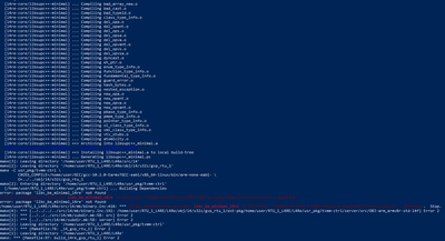

I am using Ubuntu version 20.04, and the GreenVIP version is 1.1.0. According to the description of the L4Re build environment in section ‘5.9.2.3 Build Environment‘ of the ‘UG_S32ZE_GreenVIP.pdf‘, However, When I executed the make command for the first time to compile, I received a prompt that the GCC version was too low.
I ignored this error and then executed the `make` command a second time, which resulted in an error message indicating the absence of the `libc_be_minima1_14re` library.
How to solve this issue?

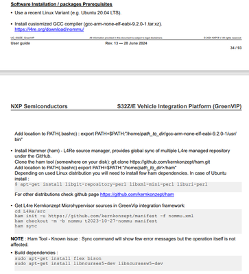

It would be suggested you to try with these commands instead, on a fresh workspace/directory:
ham init -u https://github.com/kernkonzept/manifest -f nommu.xml -b t2023-10-27-nommu
ham sync
ham info

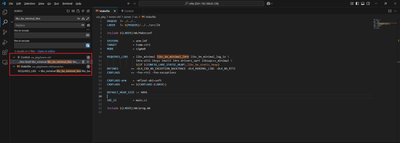

Do you know how to generate the libc_be_minimal_14re library?
I noticed that the libc_be_minimal_14re library is listed as a dependency in the Makefile located at:
S32ZE_GreenVIP_1.1.1/framework/s32e2/RTU_1_L4RE/L4Re/usr_pkg/tvmm-ctrl/server/src/
However, I couldn’t find how this library (libc_be_minimal_14re) is generated in the L4Re repository.
Could you let me know if you have any information about this?

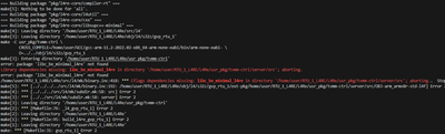

I've tried the method you mentioned, but I'm still getting the same error message as before.
The synchronization was successful, but the libc_be_minimal_l4re library is still missing.
I'm currently using an Ubuntu 20.04 environment with GCC 9.2.0, but compilation fails with versions 10.2 and 11.2 as well.
Could you share the environment where you successfully compiled it? I'd like to try compiling in the same environment. If possible, could you also provide the compilation steps?

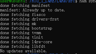

Joey_z
hi,WX_H
Thank you for your reply.
Do you use the commend as shown the following picture as the ham sync?
The meaning of entering "ham checkout t2023-10-27-nommu" after "ham sync" is to switch to the tag "t2023-10-27-nommu"
Joey

WX_H
Hi, Joey_z
Yes, after using ham checkout t2023-10-27-nommu, I still get missing library errors when running make. Additionally, I noticed that executing this command does not actually create the nommu branch.
After executing the command ham checkout -m -b nommu t2023-10-27-nommu manifest, I was able to switch to the nommu branch.
However, the compilation still fails.

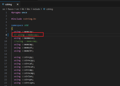

After switching to GCC 11.2, the "GCC version too low" error no longer appears, but I encountered a new error:
After commenting out the memccpy function in the file RTU_1_L4RE/L4Re/src/fiasco/src/lib/libc/include/cstringthe error is no longer reported.
However, it still reports the missing libc_be_minimal_14re library error.
Thanks.

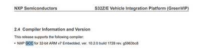

I followed your suggestion and used GCC 10.2, but I'm still getting the same error.When I executed the make command for the first time to compile, I received a prompt that the GCC version was too low.
How to solve this issue? I have another question. In section 5.9.2.3 of the UG_S32ZE_GreenVIP.pdf document, under "Software Installation / Packages Prerequisites," it mentions installing gcc-arm-none-elf-eabi-9.2.0-1.tar.xz. Does this mean that GCC 9.2 should be used to compile L4Re?
