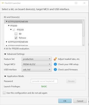

Hi.
I am inquiring about a problem with the KITPF8200FRDMPGM programming board.
In the UM11162 document, you can use the FlexGUI.
In '4.2 Installing FlexGUI software package '
NXP_FlexGUI_PF8x_Rev_0.7.x\NXP FlexGUI\bin\flexgui-app-pf8xxxx.It says to execute bat. However, the downloadable version of the file is rev 1.0.1 version and cannot be found in the bin file in folder.I could only find the file 'flexgui-app-spm.bat'.
Is there a way to download version 0.7?

Hi Hyeonbin,
the 'flexgui-app-spm.bat' is the correct file. I have downloaded the "FlexGUI for PF8100/8200/8101/8201/8121 family (REV 1.01) and I also couldn't lunch the GUI.
I needed to download and install a Java Runtime Environment. Please download it from this link. If you already have the Java Runtime Environment, please uninstall it and install it again. Also please make sure, you have English language selected in your computer.
https://support.microsoft.com/en-us/windows/manage-display-language-settings-in-windows-10-219f28b0-...
After these installation and setting completed, please double click on the 'flexgui-app-spm.bat'.
And a FluxGUI launcher should open.
I hope it will help.
