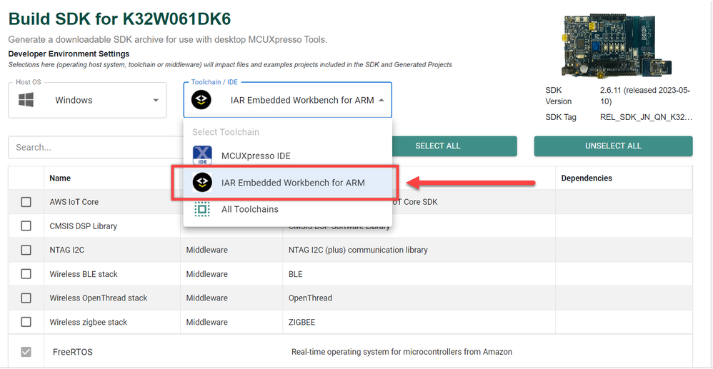

Mateusz_K
Thank you for your help. I was able to debug example using Jlink in MCUXpresso. Instructions also mentions how to import example project in IAR Workbench. However I cannot find the .eww wile in the given path. After downloading SDK for k32w061, there is only one python script in the mentioned path.
when I searched in the MCUXpresso instalation path there where no such folder as boards.
4,020 Views
EduardoZamora
If you are working with IAR, you will need to download the SDK for IAR Embedded Workbench for ARM from the MCUXpresso SDK Builder
Eduardo.
