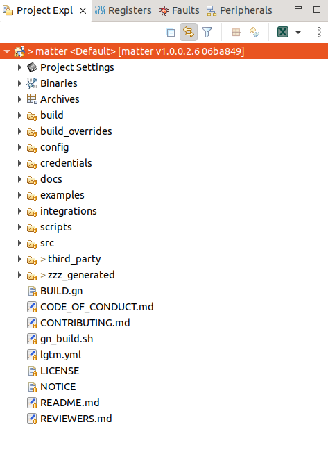

Thank you for reaching out. From what I can see in the picture you provided, the project was not properly imported in MCUXpresso. If you look in the Project explorer tab on the top-left corner of the window, there is only the examples folder, if the Matter folder is imported correctly the Project explorer tab should look like in the bellow capture:    successfull_import.pngsuccessfull_import.png
In order to help me narrow down the issue, can you right click on the project name > Show In > System Explorer and check if the opened folder contains all the files and folders present in the repository here ?
Alternatively, if all files and folders are present, can you try to go through the Debugging steps in a new workspace ? This is to make sure there is no faulty configuration in the current one that is causing this issue.
You can simply create a new workspace when you start MCUXpresso. You will be asked to chose a directory as workspace, press "Browse.." and when the current workspace folder opens go up a folder. There you can create a new folder and choose it as workspace directory, MCUXpresso will automatically do all the necessary configurations after this.

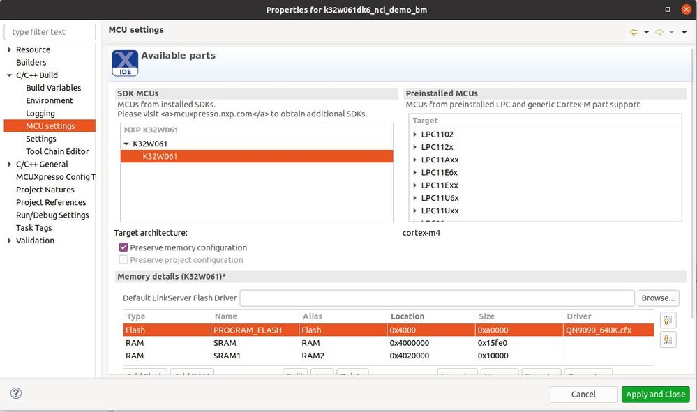

    After writing the SSBL and PSECT you will need to modify the MCU setting to change the flashing start address to 0x4000

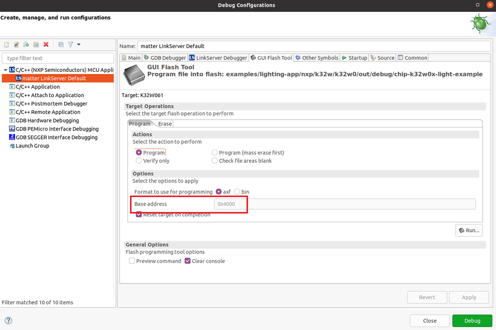

After applying the changes you can check that the configuration was correctly updated in Debug Configurations -> <your-config-name> -> GUI Flash Tool -> Program tab -> Options -> Base address field. If correctly modified it should look like bellow:

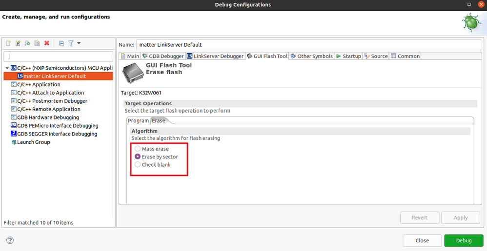

Lastly, you will need to change the Erase algorithm from "Mass erase" to "Erase by sector", otherwise MCUXpresso will erase the entire flash, including the previously written SSBL and PSECT, before writing the app. This can be done also from Debug Configurations -> <your-config-name> ->GUI Flash Tool -> Erase tab-> Algorithm section:
After this the debugger will take you to the main.cpp file and you will be able to go through the code step by step.
