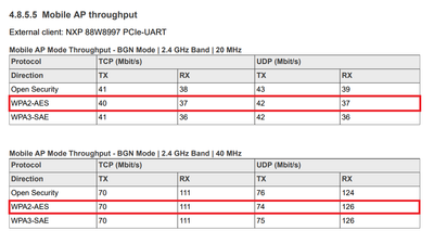

weidong_sun
Hi @rikins ,
I think your current configurations are good.
Sure, I know your module is USB 8997, you know PCIe is faster than USB, so we can take it to be a reference.
especially your test is under office environment, so the throughput is good.
Thanks!
weidong

weidong_sun
Dear @rikins ,
I feel your test result seems no problem, because your test is under office environment, not Shielded Room.
You can refer to the documents, see page 108, it is the throughput data of PCIE 8997.
https://www.nxp.com/docs/en/release-note/RN00104.pdf
Thanks!
weidong

Just to confirm once again:
I’m using USB 8997, and based on your feedback, these results (~40 Mbps) are acceptable given that it's tested in an office environment, not a shielded room — correct?
Also, my current hostapd_2ghz.conf setup looks good and doesn’t require further changes?
Kindly validate these two points so we can consider this thread resolved.
Thanks again!
Rikin
4,372 Views
rikins
Hi @weidong_sun,
Thanks for the confirmation. It was great talking to you.
Rikin
JFR, confirmation reply is pasted below.
Thanks!
weidong
