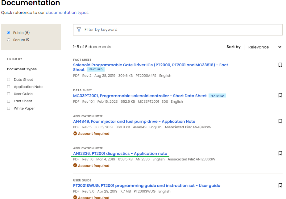

I'm trying to develop a diagnostic function for PT2001, but I don't know how to use it. For example, when I open the low or high side of the inj, the status register doesn't change. Please tell me how to use the diagnostic function and the detailed steps

Please refer to our AN12336 - PT2001 diagnostics:
https://www.nxp.com/webapp/Download?colCode=AN12336
BRs, Tomas
