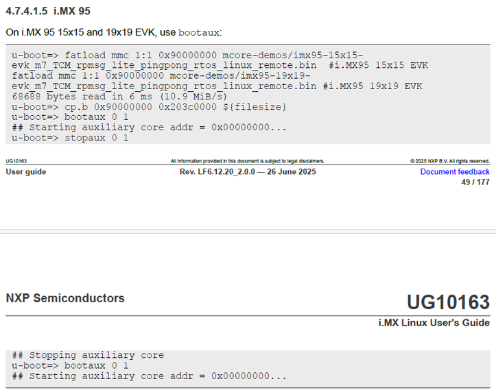

danielchen
Hi @arshad_embedded
For flashing/loading the .bin file into the cortex M7 core of the i.MX95,  please refer to UG10163,  i.MX Linux User's Guider

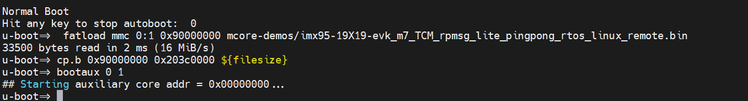

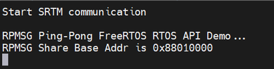

492件の閲覧回数
danielchen
Hi @arshad_embedded
I tried this on my imx95 EVK board,  it works on my side.
Then in M7 console, I can see
The UBOOT version is 202504.

danielchen
Hi @arshad_embedded
According to NXP's AN14120
i.MX95 has 4 COM ports via FT4232H USB-to-UART bridge (connected via USB-C port J31)
Port Mapping:
  • COM1 → Cortex-M7
  • COM3 → Cortex-A55
  • COM4  Cortex-M33
I would suggest you flash the latest firmware and try it again.
