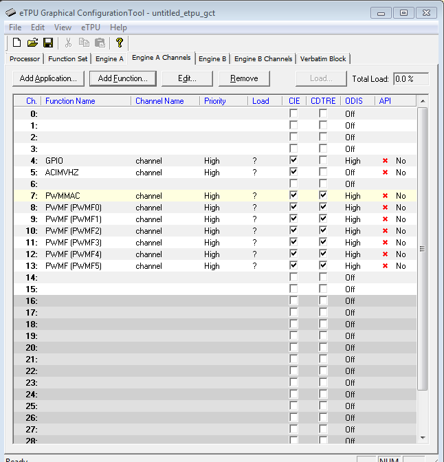

I am trying to generate .C file for MPC5566 MCUusing graphical configuration tool.
I have given path of etpu_set.h  as mentioned in GCT user manual.
But i am not able to see API has been linked to this tool.(Refer below snapshot)
Can you please let me know how to link API files to GCT and is it must to link API .
What if i generate files whithout linking API to this tool.

You have to use eTPU set downloaded by function selector (AN4687 Figure 3.) and set it into GCT (Figure 6). Then GCT must be restarted (closed and started again). Then it should work.
