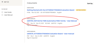

Please order the socket board of FS86 to do OTP with GUI :
KITFS86SKTFRDMEM: FS86 Safety SBC Programming Socket Board | NXP Semiconductors
Please also download the user manual for this socket,inside of this files there is detail steps for dong OTP.
Hope this could help you!
