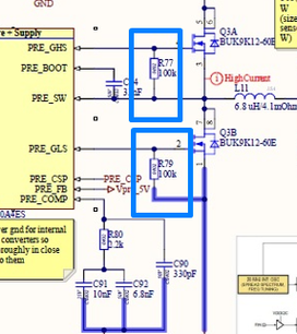

PRE_GHS seems to be okay and is in high state approx. 5 V above the input voltage of 12V. PRE_GLS seems to be also okay most of the time (e.g. 1st period, 3 periods in the middle of the record). But in some periods PRE_GLS does not turn on when PRE_GHS turns off. In This case both Transistors should be off which I guess is a undesired state, isn't it?
One can even see some kind of oscillation on the PRE_GHS signal which is really strange.
Vpre seems to have an adequate output level of 5V as long as the device keeps running.
As the connection to the programming board is instantly lost when leaving debug mode the device turns off after some seconds. I cannot decide if this is due to a failure connected to the strange behavior of the pre regulator or just due to the safety turn off features.
What can be wrong here? The schematics seem to be very much like the reference design. I've attached a schematic sheet to this message. Only thing we already noticed we forgot was the supporting capacitors for Vbos which we added to the hardware prototype. I also attached the OTP config file for use in flexGui. We therein turned off all monitors and all regulators. Only Vpre should start. The config worked fine on the programming board.

[A] I suspect the R77 and R79 resistors are too low. According to the KITFS85AEEVM evaluation board, the R77 and R79 should be 1MOhm. In your case they are 100kOhm, which might pull the signal too GND. R77=R27 and R79=R26. The values of the R77 and R79 should be different for programming and for the use case. The R77 and R79 should be 100kOhm for programming and 1MOhm for use case. And the R77 should be connected to GND for programming, and for the use case the R77 should be connected to the PRE_SW pin. Please see below screenshots for differences.

For programming please follow the SCH-SOCKETED-FS84_FS85_Programming.pdf attached. Please connect the R77 to the GND. Please add 22pF capacitor to the VPRE_FB pin. Please increase the value of the C84 to 47nF. Please connect the 4.7uF capacitor between the VBOS pin and GND.
For evaluation of the programmed FS85 please follow the FS84_FS85_EVB.pdf schematic attached. Please connect the R77 back to the PRE_SW pin and please increase the R77 and R79 values to 1MOhm. Please add 22pF capacitor to the VPRE_FB pin. Please increase the value of the C84 to 47nF.
