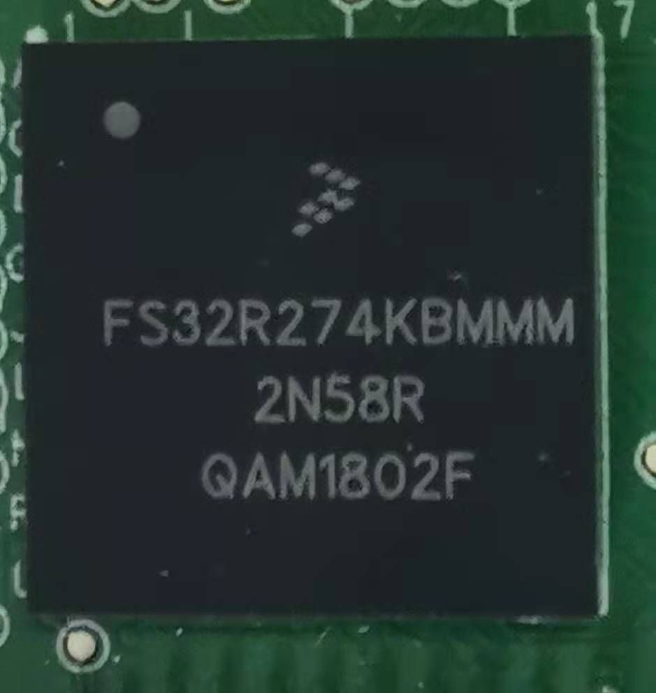

longfeiwang
Sorry K2  is  error,The silk  is shown in the picture below

lukaszadrapa
Thanks for the details.
So, we have two ordering part numbers:
FS32R274KSK2MMM
FS32R274KBK2MMM
According to marking diagram, mask set (‘K2’) is omitted in the printing on the package due to space constraints, so there’s only:
FS32R274KSMMM
FS32R274KBMMM
… and the mask set is shown below the part number as 2N58R.
These are exactly the same devices with the same silicon mask set. CSE is available in both versions. ‘S’ and ‘B’ is used only due to some historical reasons. I got confirmation there's no difference at all.
It would be necessary to have more details about the failure. Isn’t it somehow related to (other) hardware?
