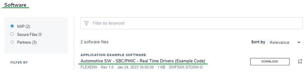

TomasVaverka
Hi Yokoyama-san,
Our AN13850 includes all the information you require in Chapter 5. This AN is classified as a Secure File requiring an NDA. If there is a valid NDA in place, you can download it from the following website:
https://www.nxp.com/products/power-management/pmics-and-sbcs/safety-sbcs/safety-system-basis-chip-wi...
You might find useful also the he FS26 RTD and example code available on the same website under Software.
BR, Tomas
