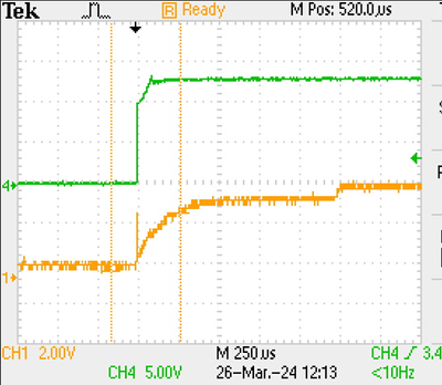

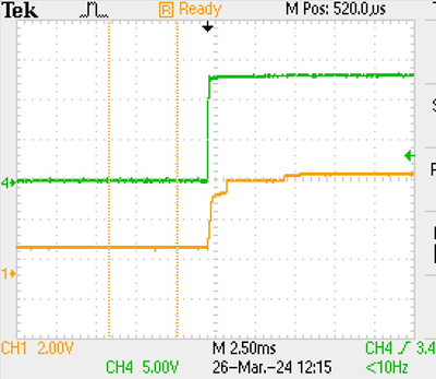

Hi David, sorry for the delay in the response.
The circuitry is similar to the one present in datasheet which is the same that you posted, with the only exception of the 10 uF capacitor and a jumper between the DBG pin and the diode cathode.
We tried both to apply +12 V at the DBG pin both with Power Supply direct connection and by passing PS ramp up time by plugging in power connector with power supply output already at steady states, the timing of the voltage changed but we could not see any differences in the behavior described (SBC register show DBG_MODE =0). Also, we tried to directly apply that voltage on DBG pin with another Power supply, same results.
Regarding the voltages sequence, with the proposed circuitry is not possible to have Vdbg > Vsup before Vsup gets high, since the Vbos output depends on Vsup. In any case, the circuit should be working if all the transitions are within a brief time interval.

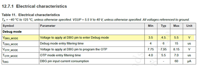

diazmarin09
Hello cf_st,
I am pleased to contact you again.
Please note that the voltage to apply at the DBG pin to enter in Debug mode is 4.5V. Could you please try with such voltage level and then read the M_SYS1_CFG register?
As we know, the FS23 enters Debug mode in M3 state of the main state machine when VDBG (DBG pin voltage) > VDBG_MODE. NXP recommends connecting the DBG pin to the VBOS pin through a diode (VDBG = VBOS – Vd ≈ 4.1 V).
David

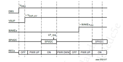

diazmarin09
I hope all is great with you. Thank you for using the NXP communities.
Could you please share the voltage at the VDBG pin? It is greater than VDBG_MODE?
Are you following the sequence below?
Is your Debug pin (DBG) circuitry as follows?
I hope this information helps.
