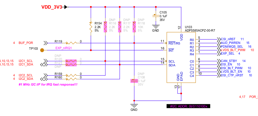

Hi NXP,
Hi, I am working on board imx93evk, I want to control LVDS brightness using flexio driver with I2c, the base board I2C device is ADP5585ACxZ-01-R7 at address 0x34 pin LVDS_BLT_PWM, I have data sheet for ADP5585ACxZ but I don't know much about how to use this i2c device as slave and resistor configuration. And how to control LVDS brightness using this device. Please provide example with document if possible.

HI @Rakesh_Kumar-Thakur!
Thank you for contacting NXP Support!
You can take a look to the next device tree for imx93 EVK.
In  this file is already configured the pwm.
Best Regards!

Hi NXP,
Hello @Chavira
Thanks for connecting actually a want to control LVDS Back light brightness  using LPI2C2 bus
  1. slave address i want to used 0x34 (ADP5585ACxZ-01-R7)  please provide information about can we use this address as a slave or not
    Screenshot from 2024-10-21 18-07-03.pngScreenshot from 2024-10-21 18-07-03.png

Hi @Rakesh_Kumar-Thakur!
Do you want to control the PWM under M core?

Chavira
We don't have the driver to control the ADP5585ACxZ-01-R7  under M core.
Best Regards!

Hi @Chavira
can we used Can I replace LPI2C1 with LPI2C2
