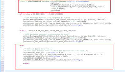

for example PN7462AU_ex_phExNFCCCid, in file phExNFCCCid_Poll.c, at function phExNFCCCid_Handle_USB_Process.
When the program runs to function phpalI14443p4_Exchange, My card has been in error many times. When that tag is removed from the handle function.
However, the card was reactivated shortly after and the Timeout error occurred again.
It's an infinite error loop.
How to remove card reactivation when encountering Timeout Error Occurred ?
/** Timeout Error Occurred. */
/** Send Card Removal Event and Mark the Transaction as Failure. */

We don't have a specific function that handle this but, is possible to manage this by performing an RF Reset on the reader and activate the card once again.
If you have another idea on how to handle this please let me know. I may be able to provide a better recommendation.

@Fabian_R Our company is using PN7462 for the project, the current number of products is about 5000, and certainly up to 50,000 products.
I want to optimize the program for PN7462.
Currently, there are a small number of cards experiencing card reactivation after the timeout period has passed. I want to stop avtive card after timeout until the card is removed from the tray

Unnecessary.
Because we tested with many different types of NFC readers.
And that's because the card is locked, making the data inside the card unreadable, leading to an infinite card activation loop.
This case can only be handled by software.
With some other NFC readers, after detecting a data key tag, the NFC reader waits until the tag is removed from the tray

That's right, however, the PN7462 program, after detecting the error card, will push the card out of the loop of the phExNFCCCid_Handle_USB_Process function, then continue to activate the card and run the phExNFCCCid_Handle_USB_Process function, then break again,... I want to stop this, and wait for the tag to be lifted off the antenna
