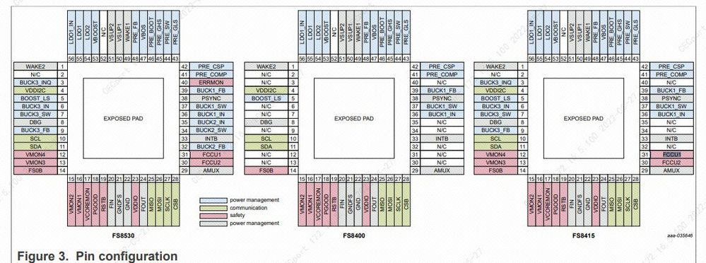

What pin does MC33FS8430G1ES  have? I only found the series pin definition in FS84_FS85C,but MC33FS8430G1ES is having buck3,which is different from FS8400 series.I want to use FCCU1 or FCCU2 as watchdog monitor, so I wonder if MC33FS8430G1ES has this pin?

8430的引脚BUCK1/2/3配置跟8530一样的,FCCU and VMONX配置跟8400一样。

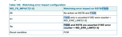

WD的外部监控是RSTB可以做,FS0B也可以但是要通过下面的设置:

RSTB跟FS0B 都是safety function 输出脚位,如果MCU喂狗有错误,错误会累加累加到最大值RSTB、FS0B就拉低了根据我上个回复的插图。

Please get note that FS8430 doesn't have FCCU pins.
3,888件の閲覧回数
jingfang
您那有文档有定义8430的引脚不,可以分享我一下么?
或者有哪个引脚可以作为MCU的watchdog外部监控?
因为该案子是匹配S32K1有EWM,我想连到MC33FS8430G1ES的引脚,作为外部watchdog监控。
