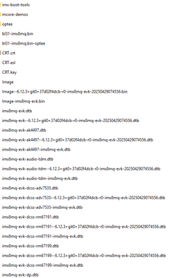

Hi, I've been trying to build a linux OS for my motherboard IMX8MQ M8M051.
I've tried multiple times and nothing seems to work. I have finally compiled a new image (MACHINE="imx8mq-evk", DISTRO="fsl-imx-xwayland", IMAGES="imx-image-core"), but I have not been able to deploy it.
I build my image based on the nxp documentation for yocto :
https://www.nxp.com/docs/en/user-guide/RTEDGEYOCTOUG.pdf
https://www.nxp.com/docs/en/user-guide/IMX_YOCTO_PROJECT_USERS_GUIDE.pdf
When trying the following line, nothing happens... :
.\uuu.exe -b emmc_all imx-boot-imx8mq-evk-sd.bin-flash_evk imx-image-core-imx8mq-evk.rootfs.wic.zst
The thing is, i'm using the files mentionned in the documentation....
I have the manufacturer image (only the one to deploy not the build) and that one works (I can deploy it), but for technical reasons I have to build my own image. As I know that the problem is not the hardware but most likely the image I build...
If anyone has questions, ideas or advice, I would be more than happy to hear them !

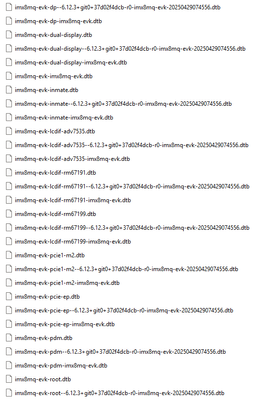

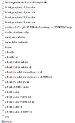

In case the files I use aren't the right one, here is all the files in my deploy image folder :
