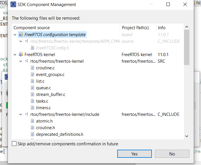

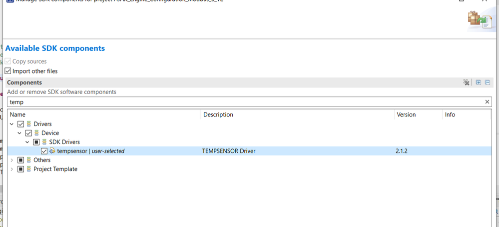

I am using MIMXRT1176AVM8A controller and FreeRTOS for my project. I need to measure the temperature of the controller, but when I try to add the driver for tempsensor it is removing the FreeRTOS drivers.
How can I work with tempsensor without affecting my FreeRTOS.
I have attached screen shots for reference.
SDK version is 2.16

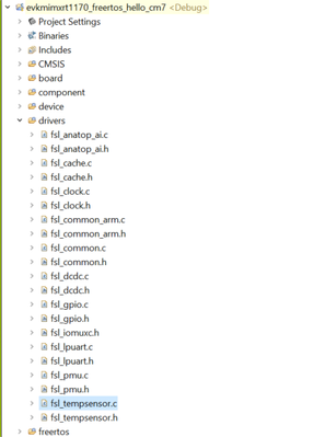

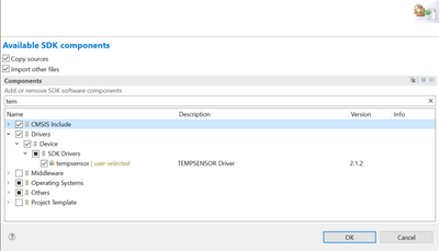

I used the freertos_hello_world_cm7 example demo in the SDK as a start, adding this component did not affect freertos:
Gavin_Jia_0-1729670665203.pngGavin_Jia_0-1729670665203.pngGavin_Jia_1-1729670705970.pngGavin_Jia_1-1729670705970.png
Also, this driver should only have one .h/.c files, you can also try to add them manually.
