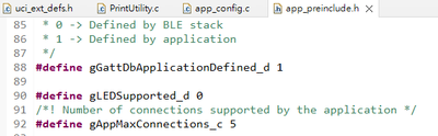

1. Default Device Connection Number:
I'm now using the Nearby Interaction (TWR method) between EVK and iPhone.
There is a multi-ranging option controlling the max number of connections,
in the file app_preinclude.h, the macro is gAppMaxConnections_c.
show below:
The default value of it is 5.

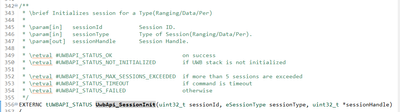

4. Problem: Where to change the number of connection > 5?
When I set the gAppMaxConnections_c to 8, it can only connect to only 5 devices (iPhone).
I find where is limited the connection.
In the file UwbApi.c and function UwbApi_SessionInit.
Its information mentions that max connection is 5.
I want to know if there is a way I can change the max connection > 5?
