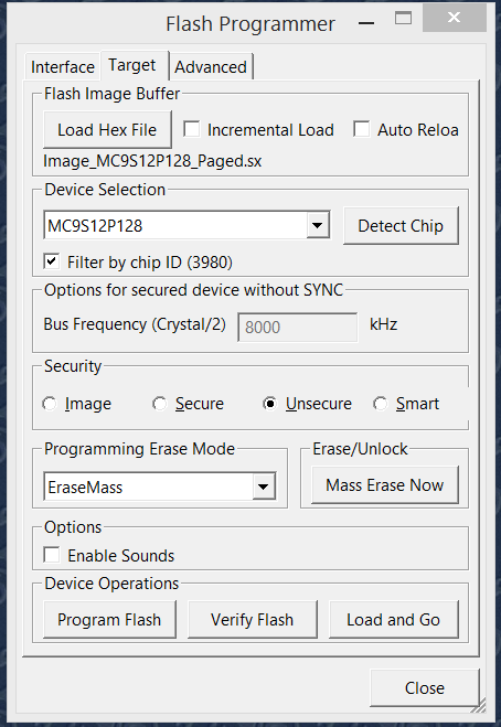

Hi! I've an old WTBDMS08, JB16(28-PIN based); I need to flash an hcs12, so i've tried to update fw. I installed USBDM 4.11.1.20, and run firmware update. but the application dosen't recognized my tool and said (USB unknown error). so i flashed  JB16 with the WTBDM_JB16.s19 (found in FlashImages folder); Windows don't recognized the Hw, it said "Unkown device", and when i tried to install driver it don't acept it. Anyone can help me to solve my problem? (I use Win7 32-bit, codewarrior 6.3)

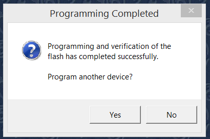

I tried the latest version of USBDM (V4.11.1.4) with a Witztronics JB16 BDM and it seems to work OK with a HCS12 device.
I used the firmware included (V4.10.2) with that release.
I had to do the firmware update on a Linux machine.
