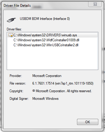

Roger,
Could you compare your Driver details from the Hardware manager with the screen attached?
43,142 Views
RogerSchaefer
Dear pgo,
It’s the same except I have an extra driver dll
/usbdmlcons.dll
see attached
Thanks for your effort,
Roger
