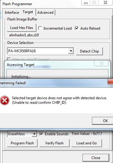

Hi pgo,
Using 4.10.6.140 I have MC9S08PA16 on my board and it only can be programmed if selected as PT16.
If selected the right device "PA16" it cause this error:
Tell me how to fix it.

Hi Luciano,
The manual for the chip indicates that the SDID is 0x0042 so it looks like the first digit is the mask revision.
I've changed the SDIDmask in the attached file which should have the same effect as the changes you made but also work with the version given in the manual.
I would appreciate it you could test this.

Hi Luciano,
I've attached an updated hcs08_devices.xml file.  Can you replace this file in the USBDM installation and check if it works correctly with your devices.
Place in directory C:\Program Files (x86)\pgo\USBDM 4.10.6.170\DeviceData
If this doesn't work correctly could you provide the ID number that the programmer detects?

Hi pgo,
First test it stop working for PT16 too, then I changed the SDID and it works fine!
The SDID for PA8 and PA16 is 1042 (tested for both), I edited your new hcs_device.xml, now it can detect chip for PA8 and PA16.
See file attached with new SDIDs.

Hi Luciano,

I tested and it works perfectly!
