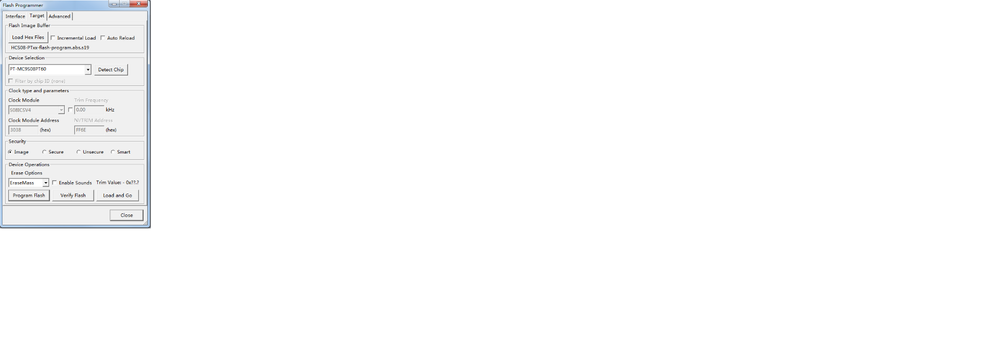

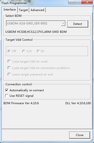

I set the stand-alone HCS08 programmer as shown in Fig.1 and 2 programmer setting 1.png
Fig.1
Fig.2

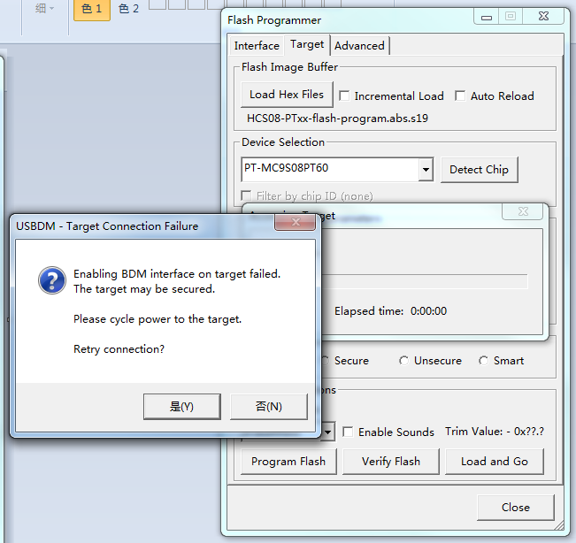

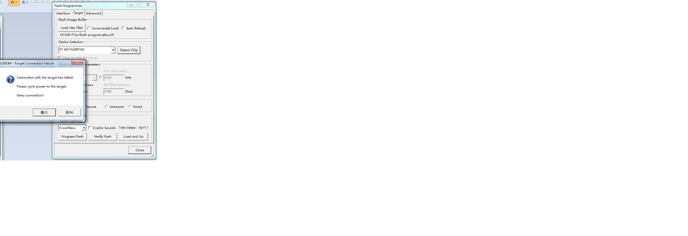

When I tried to detect the chip ID, it started to give errors in following figures:

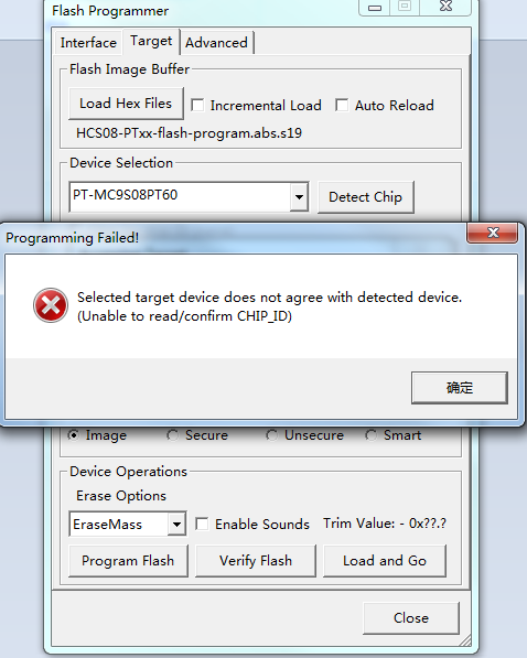

I also tried to load the Hex file: HCS08-PTxx-flash-program.abs.s19. The programmers gave such following errors:
