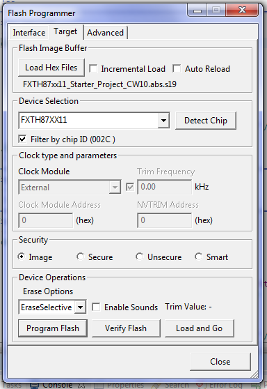

OK my sample arrived and with access to this I am able to do a proper job.
The first thing I did was create an image of the chip contents.  This allows the chip to be returned to a "factory fresh" state if the firmware is accidentally erased.
Any way I have attached the following:
  • Image from a FXTH870511, FXTH870511_Image.sx  I hope this is OK. If not Freescale can feel free to delete with accompanying rude words.  I presume they won't object since the image is unprotected in the device and easily read.
  • Updated device file hcs08_devices.xml  This adds three devices FXTH870000, FXTH87xx11-Full-Erase and FXTH87xx11
    • FXTH870000 This is an alias for use with Codewarrior and doesn't appear in the stand-alone programmer.
    • FXTH87xx11-Full-Erase This is a device entry that allows completely unprotected programming of the device.  This can be used to re-program the device with the above image using mass-erase.
    • FXTH87xx11 This is an entry that only allows programming the intended user area of the Flash.  Due to limitations in the USBDM programmer it is not possible to prevent you from mass-erasing the device  - You have to manually select selective erase.
Further tips:
To restore an accidentally erase device
  • Load the above image FXTH870511_Image.sx
  • Select Image for security
  • Select EraseMass
  • Program and verify to check it's OK
To program a user program (restricted to user flash area)
  • Load the above image file .....
  • Select EraseSelective

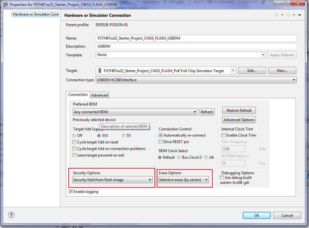

To use with Codewarrior
  • Create project in usual way with a USBDM target interface.
  • Modify the USBDM options as shown below
    • Security field from flash image (there won't be one)
    • Selective erase (by sector)
  • You should be able to debug in the usual fashion

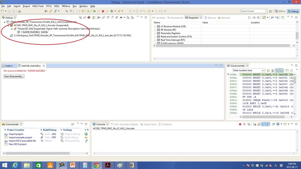

i'm also facing same kind of issue, with Debugger Mode .Firstly i'm working with FXTH870911 434Mhz TPMS Sensor.I have facing the problems like I not able to debug the Sample Code and no sample code executing int he EVB.
#1.I have downloaded Startup Code from free scale there i faced issue with Firmware JUMP Location (0XE003). This i have got clear SW not able to access the address location.
#2. Then i have downloaded the Sample code "FXTH87XXXX PERIODIC RF TRANSMISSION CW10" and flashed with EVB, I have selected FLASH_434_2_AXIS Vehicle Type .s19 file. Please note very first time FR DATA have been transmitted i have used Spectrum Analyzer to test the FR Signals. Then i have modified the transmitted Data size and flashed this time code not working no RF Data Transmission, then i have revert back to original code and flashed this time also no RF Data Transmission.
#3. Next i tried to debug the flashed code i got Debugger connection loss error as well the  Firmware Jump location error when i suspend the Debugging Progress.From this time onward no longer working with any of the sample code.
#4. If i try to reset the Target this will jump to the Firmware address 0xFFFF address instead to the vector address.
#5 . I hope i have accidentally erased the  builtin Firmware data,but i don't have any idea how to restore my IC to normal working conditions.Please any can help me for the steps to resolve this issues.
#6. I have using CW10.6 with TPMS supported component installed. Please node this are the thing im using for my development (FXTH870911 and P&E Micro Cyclone Pro) Debugger.
Please this will be very great-full if any one help me out.

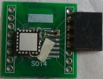

I also want to work on the FXTH87, so I want to get a EVB for reference. You build the hardware circuit yourself or get it from Freescale? Look forward to your reply!
Thanks.
11,973 Views
jiangboli
Hi Yaping Wang,
I design the PCB of FXTH87 by myself,and it works normally.But I think the RF antenna is not perfect.
By the way,Are you Chinese?
bye
