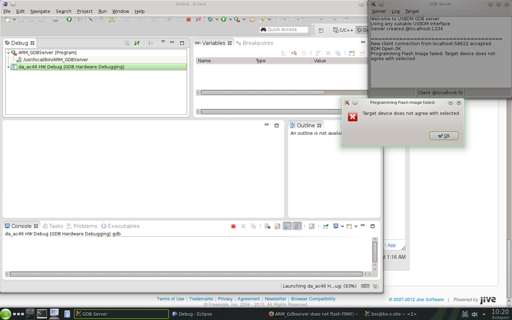

The  ARM_FlashProgrammer works fine and flashes the KL46Z, but ARM_Gdbserver gives this errror!
For KL25Z works fine.
Sándor
(gdb) load

Programming Flash Image failed: Target device does not agree with selected

Hi Sandor,
the line
indicates the incorrect device is selected.
How are you selecting the device?  If you are starting the debugger from Eclipse you need to set the device there.  If you are running it stand-alone then you need to select it in the Debugger dialogue.

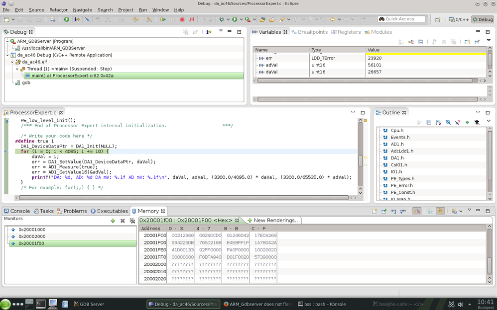

Unfortunately I found an other issue with gdbserver.
I flashes the KL46Z by ARM_FlashProgrammer.
Start the gdbserver.
Debug the program.
BUT the debugger able to read only 16k of rams.
In case of KL46Z, ram starts at 0x1fffe000 ends 0x20006000, but the debugger only see up to 0x20002000.
For this small test program I must set the end of stack to 0x20002000  to see the local variables and to be able to step the program correctly.
Yesterday I compiled your latest OPEN_SDA firmware from your git because I've seen your new commits, but the situation is the same.
Anyway, I like very much these tools, because I work on SuSe linux and now I do not need to go to VirtualBox XP's CodeWarrior  to develop and debug.
I appreciate your hard work very much!

The ram error is found
in arm_devices.xml
      <memory id="kinetisL32K_Ram" type="ram">
         <memoryRange start="0x1FFFE000" size="16K" />
      </memory>
changed to 32k and it work well.
