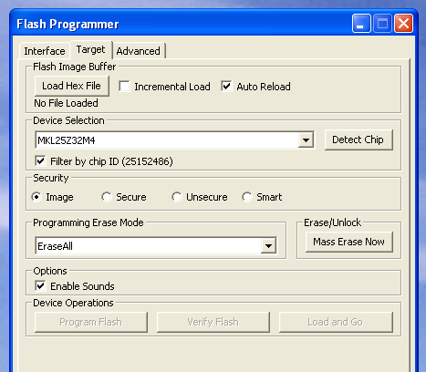

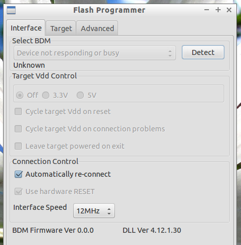

I have problem with Arm Flashprogrammer under Linux (Ubuntu 14.04).
The application failed to detect the FRDM-KL25Z(same with KL26Z) board.
USBDM version is 4.12.1-30
Linux version 3.13.0-68-generic (buildd@lgw01-46) (gcc version 4.8.2 (Ubuntu 4.8.2-19ubuntu1) ) #111-Ubuntu SMP Fri Nov 6 18:17:06 UTC 2015
(I tryed with different 3.13 kernels..)

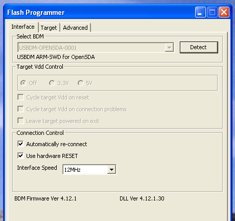

when I press the "Detect" button the firmware version randomly changes..
Same version works perfectly under windows !
Any idea ?

fmiku
Problem solved !
The current USER was no write permission to the libusb devices.
so I added the following line to the "/etc/udev/rules.d/46-usbdm.rules" file.
SUBSYSTEM=="usb", ATTRS{idVendor}=="16d0", MODE="0664", GROUP="plugdev"
and the currend USER have been added to the plugdev group.
(sudo gpasswd -a USER plugdev)

fmiku
your original and attached versions are mismach @ line 11 on hex number "06A5"
the original is contains UPPER case letter :smileyhappy:
The new rules works fine without any modifycation !
I just noticed your line 2 :smileygrin::smileygrin:. and this is the key why my rules somtime works somtime not, I'm mostly using UPPER case hex numbers ...
so a BIG thanks to you:smileygrin:, that solves lots of my problems... :smileyhappy:
