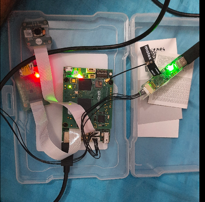

I am not able to connect to navq using serial. With the old os on the sd card i have once connected to navq using putty. Then I disconnected all cables and tried again this time i was not able to connect to navq. I flash the latest os the one i mentioned before but still not able to connect to serial.
Would like to know if my board is booting properly. Attaching images of the board.

The reason why your flash is failing on eMMC is probably because your NavQ has a 4GB eMMC chip, which was shipped out on most NavQ boards. Unfortunately, you can not flash the hovergames image to eMMC if you have a 4GB board, as the image is too large.
As for the SD card issue, can you try flashing the image before extracting the .bz2?
Landon
