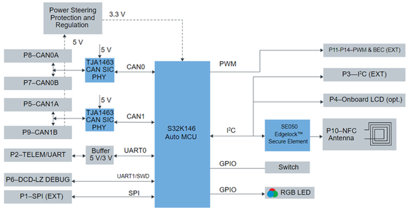

The UCANS32K1SIC provides two CAN SIC interfaces and is based on the S32K146 (32-bit Arm® Cortex®-M4) from the S32K microcontroller family. Also, the UCANS32K1SIC features EdgeLock® SE050 secure element for authentication and encryption development. For complete details, please access the following link
1.2. Block Diagram

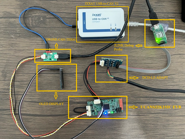

2.2. Prerequisite Hardware
For the development of this application, the following hardware is required:
  • UCANS32K1SIC evaluation board
  • DCD-LZ-ADAPT debug adapter with cable, which provides breakout connectors for SWD/JTAG Debugger and FTDI USB-UART
  • CAN Bus Terminator (DRONE-CAN-TERM) with MicroUSB cable
  • CAN cable terminated on both ends
  • OLED Display 128x64 pixels
  • JLink Debug Probe (or any other compatible SWD probe)
  • IXXAT USB-to-CAN V2 (or any other canAnalyser )

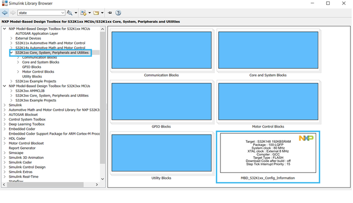

After the NXP Model-Based Design Toolbox for S32K1xx is installed, the next step is to open the library and drag and drop the necessary blocks.

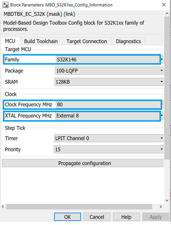

The MCU configuration with MBD_S32K1xx_Config_Implementation block
The first step is to add the MBD_S32K1xx_Config_Information into our Simulink model. This action makes the model aware that it will generate code for the S32K1 microcontroller.
Once opening the block, the user needs to choose the processor family inside the MCU tab. For this particular board, the processor is S32K146.
Then the system clock frequency (MHz) must also be specified:
  • Clock Frequency Value (80 MHz)
  • External Crystal clock - 8 MHz (check the schematics or other materials)

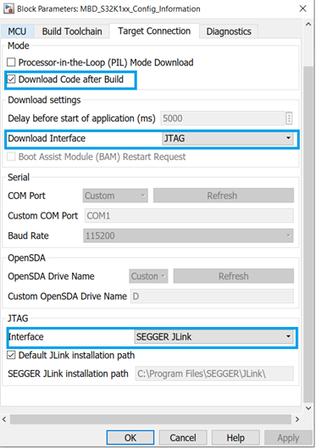

In the Target Connection tab, the following settings are required: The download interface JTAG and SEGGER JLink software. In our case, the kit comes with the SEGGER JLink so we are selecting this one. In case the JLink software is installed at a different location than the default one, the correct path shall be indicated in the “SEGGER JLink installation path” field.

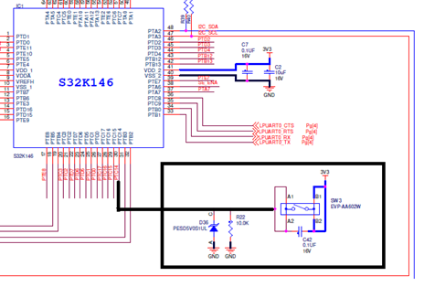

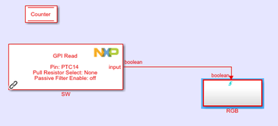

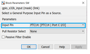

3.1. Reads the Switch state (GPI)
In this application, each push of the button selects which color of the RGB LED is lighten up. So, to be able to control that, the state of the button needs to be read. A variable named “counter” stores the values corresponding to each state (0-RED, 1-GREEN, 2-BLUE).

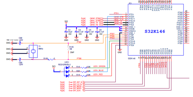

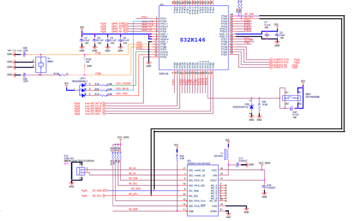

The pin corresponding to the SW button reading must be configured (using the schematic for the UCANS32K1SIC evaluation board).
With each execution of the main step in the model, the GPI Read block triggers the subsystem where the states of the LED are changed.

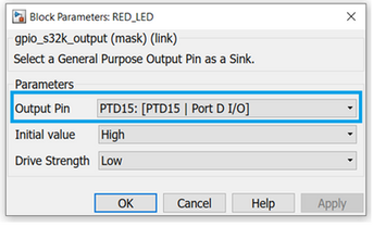

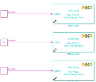

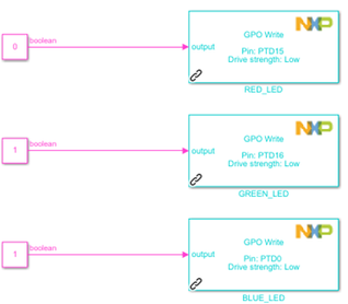

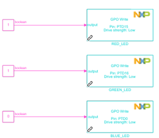

3.2. Controls the RGB LED (GPO)
When the counter is incremented, the LED changes its state (RED-GREEN-BLUE).
This is implemented using the GPO Write blocks.

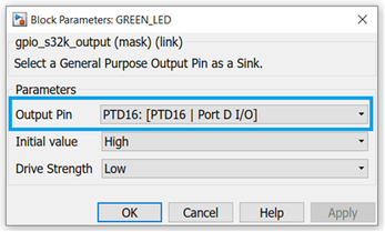

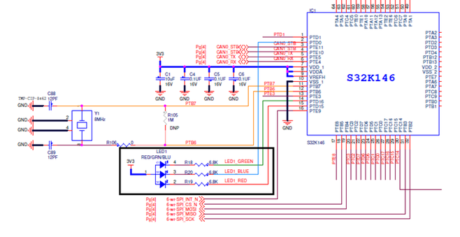

The pins corresponding to each LED color must be configured according to the schematic.
After identifying each pin, they must be set in GPO write blocks as follows:
To turn on one of the LEDs colors, set the pin to 0 and to turn it off set it to 1. This is because the LED anode is routed to 3V3 and the cathode is connected to the pin. When the application requires to turn on only one color, the others must be turned off, as might be seen in the screenshots below.

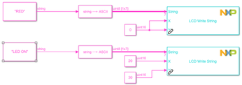

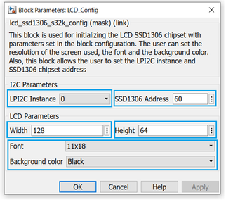

3.3. Displays messages on the LCD screen (“Red Led On”, Green Led On”, “Blue Led On”) using the I2C communication protocol
For this example, the OLED display used is 128 x 64 pixels. The LCD communicates with MCU via LPI2C0 (P4). So, in order to communicate with the OLED display, the LPI2C instance must be first configured.
LPI2C0 block configuration:
The pins corresponding to LPI2C0 instance must be configured according to the schematic.
Next, the OLED block  needs to be configured as follows:
After the LPI2C0 and OLED blocks are configured, messages can be displayed on the LCD screen using the LCD Write String block.
LCD Write String block configuration:
To display the other messages (GREEN LED ON and BLUE LED ON), the steps are the same.

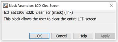

To clear the LCD screen and  display another message, the LCD Clear Screen must be used.

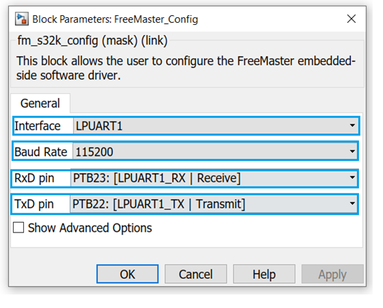

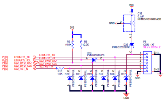

In this example, we used the LPUART1 interface to send/receive messages from the FreeMASTER application.
The pins corresponding to LPUART1 (they are routed to the P6 connector) instance must be configured according to the schematic.
The RxD and TxD pins required routed in the schematics are PTC6 and PTC7. Another parameter that must be configured is the Baud Rate (maximum number of bits per second to be transferred). For this application, the Baud Rate is 115200 kbps.

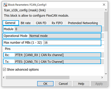

First, CAN0 instance needs to be configured. For this action, the CAN configuration block is required.

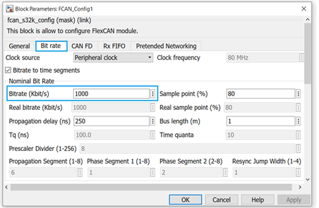

In the General tab, the following settings are:
  • Module: 0 (for the CAN0 instance)
  • Operational Mode: Normal mode
  • Max number of MBs (1-32): 16
  • The RxD and TxD pins required are: PTE4 and PTE5 (according to the schematic)
In the Bit rate tab, the default Bitrate is 1000Kbit/s, but it depends on the case.

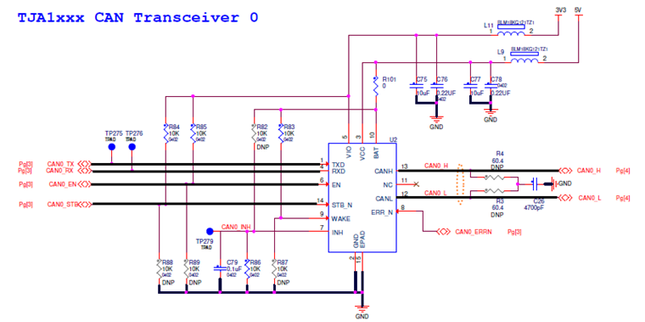

The next step is to choose the operating mode for the CAN transceiver (for UCANS32K1SIC, the CAN transceiver is TJA1463).
The TJA1463 is a member of the TJA146x family of transceivers that provide an interface between a Controller Area Network (CAN) or CAN FD (Flexible Data rate) protocol controller and the physical two-wire CAN bus.
Control pins STB_N and EN are used to select the operating mode. To simplify the application, the Normal mode has been selected to be set for the entire execution of the application.
HIGH-level state on pin STB_N and pin EN selects Normal mode.
According to the schematic, for the instance of CAN0, the corresponding pins for STB_N and EN are PTE11 and PTA10.

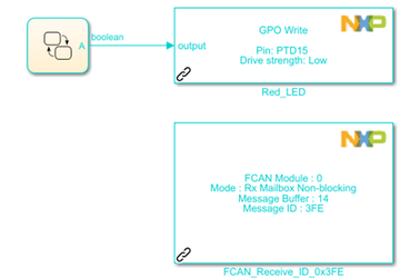

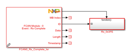

A numeric sequence with the ID 0x3FF is sent continuously while a  message received with ID 0x3FE toggles the PTD15 (Red LED) on each receive.
To receive a CAN message asynchronous with the application, the CAN receive interrupt must be used.
When a message is received, it triggers the subsystem Rx_0x3FE.
The fcan_s32l_receive block configuration is:
  • Module: 0
  • Mode: Non-blocking
  • Message Buffer: 14
  • ID: 3FF
  • ID mask: FFFFFFFF

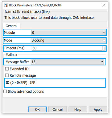

To send a message with the ID 0x3FF on CAN0, in the fcan_s32l_send block, the following settings are required:
  • Module: 0
  • Mode: Blocking
  • Timeout (ms): 50
  • Message Buffer: 15
  • ID: 3FF

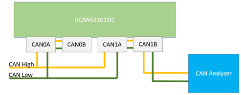

A CAN Analyzer is needed to analyze and collect data from the CAN bus and display them on the PC.
To use both CAN instances on the same  CAN Analyzer, a hardware connection is needed between CAN0A and CAN1A (or any CAN0 with CAN1).
This can be seen in the following diagram:
In this application, the  CAN Analyzer used is IXXAT USB-to-CAN V2 and the software interface is IXXAT canAnalyser3 Mini, but of course, any other CAN Analyzer can be used.

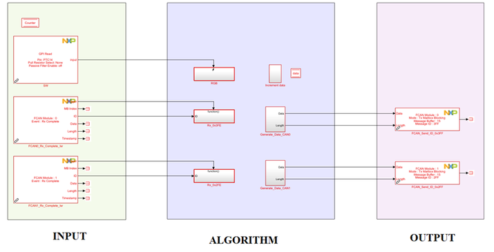

4. Model overview
The application is structured in 3 categories as follows:
Input (green area): Hardware-dependent blocks that read/receive values from peripherals
Algorithm (blue area): Hardware-independent blocks that process the values received from Input blocks, runs the algorithm and controls the outputs.
Output (pink area): Hardware-dependent blocks which receive the processed values from the Algorithm blocks.

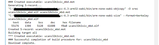

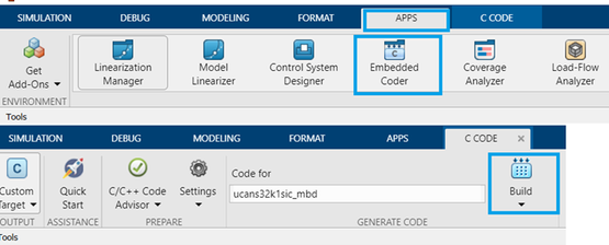

After all the steps have been followed, the code can be generated, compiled, and deployed on the target.
To do so, Go to Simulink -> Apps -> Embedded Coder then click on the Build button.
In the Diagnostic Viewer, the process can be analyzed if there is any error and if the download was successfully completed on the target as in the image below:
The following figure shows the setup:
